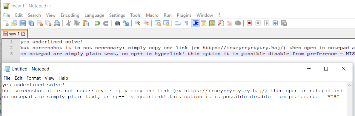

                        yes underlined solve!
                        but screenshot it is not necessary: simply copy one link (ex https://irueyrryrtytry.haj/) then open in notepad and open on np++ and you see the difference!
                        on notepad are simply plain text, on np++ is hyperlink! this option it is possible disable from preference - MISC - enable or not link clickable, but i would like to know if there is a way to convert my txt on plain text…

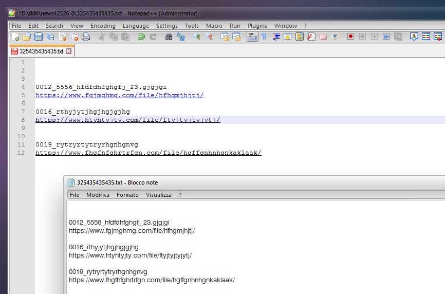

                                  I didn’t want to post my screenshot because they are private data (those of the txt) but since my problem is perhaps not clear, i modified them and here i attach a screen: https://postimg.cc/0rHdTzH7
                                  • cisco779kC Offline
                                    cisco779k
                                    [sorry but I can’t insert a direct image here: when I click on insert image it comes ![alt text](image url) but insert url i don’t see on preview my image… then i have post url of my image]
                                      cisco779k
                                      and this also happens in a new document: perhaps it is the prerogative of np ++ to always show clickable links and perhaps this is possible only by disabling preferences.

                                        all text, preceded by https:// or http://, is seen by np++ such as linkable.
                                        only way is disable from preference - MISC or delete https:// or http://
                                          @cisco779k said in remove hyperlink:
                                          Yes, that is the expected behavior. You either have to configure notepad++ to not underline links, or you have to make sure there are no links in the text; either one will stop notepad++ from underlining your text as a link.
