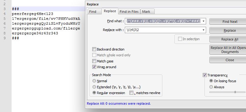

                      • cisco779kC Offline
                        cisco779k
                        @Terry-R
                        do not angry! your regex work fine.
                        @guy038
                        tanxs (ever) for your help!
                        but not work for me… why??
                        in some cases i also have 9 lines (between ### field)…
                          cisco779k
                          @guy038
                          your reg-ex don’t work…
                          please read this post!
                          1 Reply Last reply Reply Quote -2
                            Hello, @cisco779k, @Terry-r, @astrosofista, @alan-kilborn and All,
                            Please, don’t be so rude : I’m only trying to help, freely and I also answer to other people !
                            You said, previously :
                            in reality i would just like to invert the first with the last line, in any ### field
                            and also :
                            But, given the initial text, below, ( which may not respect your logic ! Just an example )
                            1234567890                         1234567890
                            17ergergom/file/wv7PNHVud9kA       ergergerggupload.com/filerge/uU8CesyKVkPb4MWk_0VqkQ/1554th11.7z
                            1ergergergegQy2iSLvFyoduWHrU       1ergergergegQy2iSLvFyoduWHrUjN7g/1554th18.7zg
                            15o4fkfk4lf,dfmemfgermp            pasdcd555ye2018
                            6664lekrflkeuN3s5lmSigp56ove       6664lekrflkeuN3s5lmSigp56oveKPp6w/erferfef3443r3434
                            pasdcd555ye2018                    15o4fkfk4lf,dfmemfgermp
                            ergergerggupload.com/filerge       17ergergom/file/wv7PNHVud9kAerAP3_WO-g/1554th0810.7zg
                            ergergerge34r43r343                peerfergeg4Me<123
                            0987676543210                      0987676543210
                            after running my regex S/R :
                            SEARCH (?-s)^(###.+\R)(.+\R)((?:.+\R)*?)(.+\R)(?=^###)
                            REPLACE \1\4\3\2
                            it does give the expected text :
                            Obviously, the first and last line, made of digits only, are inverted ! So what ?
                            Best regards,

                                  well: you have read my post above? with your reply you have published same reg-ex of your previous post.
                                  and not work for me… same reg-ex.
                                  perhaps it is i who do not understand.
                                  now i have this example:
                                  peerfergeg4Me<123
                                  ergergerge34r43r343
                                  this is only 5 line, but on some case i have field to 9 lines.
                                  i want reverse first with last line like this:
                                  ergergerge34r43r343
                                  peerfergeg4Me<123
                                  on this example your reg-ex not work (for me).
                                      Oh…, @cisco779k, I’m sorry ! I did not notice the differences between your example, below :
                                      ergergerge34r43r343
                                      peerfergeg4Me<123
                                      and my example :
                                      peerfergeg4Me<123                  ergergerge34r43r343
                                      • In your example, the header string ### is immediately followed with a line-break
                                      • In mime, the header string ### is followed with blank chars and an other string ###
                                      So the obvious correction to do is to use the following S/R :
                                      SEARCH (?-s)^(###.*\R)(.+\R)((?:.+\R)*?)(.+\R)(?=^###)
                                      REPLACE \1\4\3\2
                                      As you see, only the first + symbol, of the regex, has been changed into a * symbol, meaning that string ###, beginning the line ( ^ ), must be followed by 0 to n standard characters (.* ) before the line-break ( \R ) !
                                      I should have remarked this difference before which would have avoided you to post again ;-))
                                        cisco779k
                                        @guy038 tanxs you so much for your explanation and for modification to your reg-ex!
                                        now it works very well!
                                        I never said I had an example like yours, but maybe it’s my fault that I didn’t explain myself well …
                                        everything is working fine now. always thanks for your regex!
