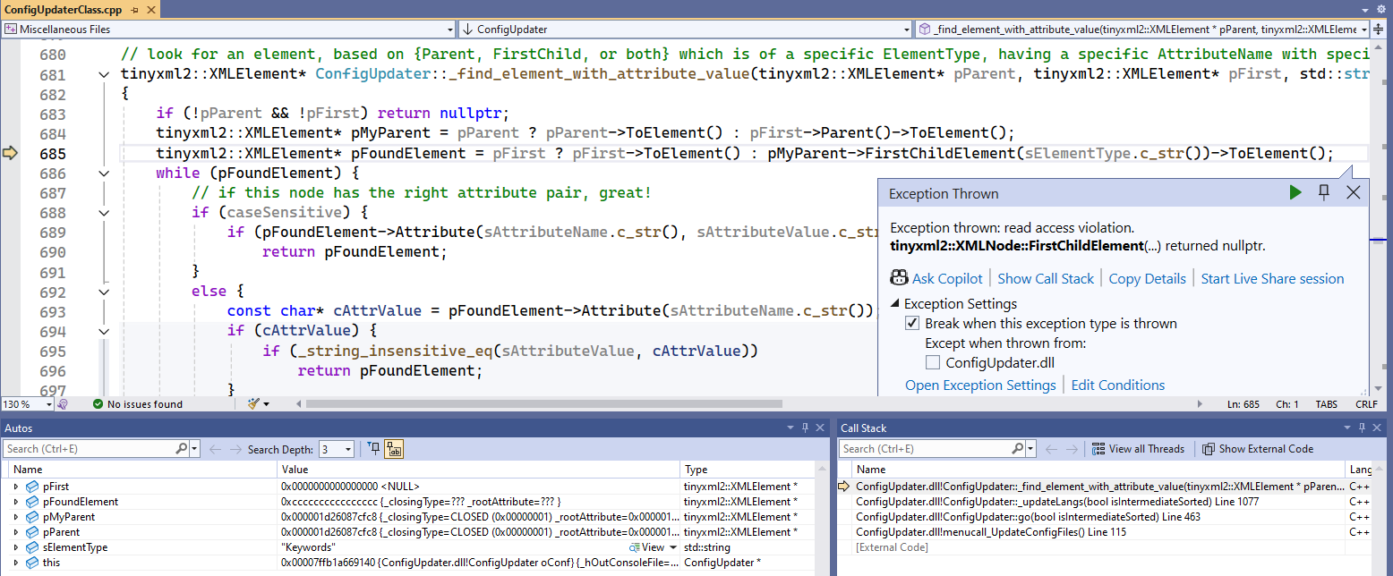

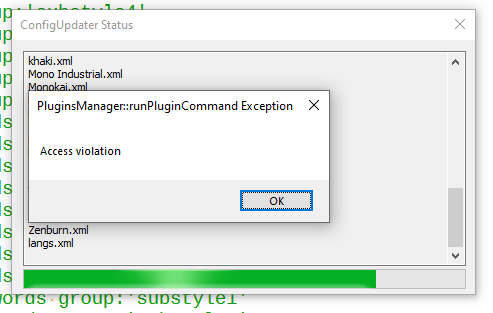

                                    I am on Windows 10. With my ControlledAutoIndent plugin installed (even when Enabled is not checked — in which state it should be doing nothing), I get the same result as @Lycan-Thrope.
                                    When I removed it and tried again, I got through the first phase and encountered the request to restart. After answering OK, waiting for relaunch and then selecting Update Config Files again, a bunch of activity occurred, and then this came up:
                                    This much is reproducible. I will try to investigate further. Debug info (captured before running first phase without ControlledAutoIndent):
                                    Notepad++ v8.8.1   (64-bit)
                                    Build time : May  3 2025 - 18:41:09

                                      Coises
                                      I can give you this much concerning the apparent cause of the access violation:
                                      but I don’t know what to check to determine what might be leading to this condition. Quite possibly I have some very old version of one of these files, because as best I can remember, I have never manually edited any of them except (I think) shortcuts, and I’ve never bothered to try to upgrade them outside whatever the Notepad++ installer does.
                                        PeterJones @Coises
                                        @Coises ,
                                        Edit to add 2: The problem with ControlledAutoIndent was entirely due to a mistake in that plugin. It’s not even a “conflict,” just a straight-up error. I had no idea what would cause an “External Lexer” to be used. (The plugin keeps track of the current language so it knows what indentation rules to apply.) I made a silly mistake in the code that handles the External Lexer case, and just never hit it until now.
                                        I’m not sure why the ConfigUpdater plugin would trigger your plugin to think there was an External Lexer (it is not a lexer plugin, after all)… but I’m glad you found that one.
                                        Edit to add: I continue to get the Access Violation in the second phase even after removing all plugins except ConfigUpdater. I will continue to search for the causes of both errors.
                                        Access Violation implies that there’s a null pointer someplace. I thought I’d fixed that for all the styler/themes, but with langs.xml being the last message in the status, maybe I didn’t check properly in the langs-updater. I’ll go take a look. (However, my normal debug in Win11 and my VM+Win10 tests all worked just fine for both themes and langs, so I still cannot reproduce the problem that’s causing that, so even if I find something, I’ll have to rely on you to test if I’ve actually fixed it.
                                        While I am looking, could you try to do CANCEL instead of YES, and see if you still get the Access Violation at langs.xml when you are not running in Admin mode?
                                        update 1: I see you posted a reply just before my post: thank you for that Call Stack: I will start my search at line 1077. :-)
                                        update 2: could you go to the issues page and create a new issue (this Access Violation is separate from the freeze/crash, I think), and attach your langs.xml to the issue? Maybe with that file, I’d be able to reproduce the problem.

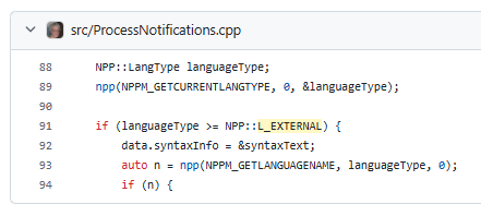

                                          Coises @PeterJones
                                          @PeterJones said in Config Files Need Updating, Too:
                                          Apparently ErrorList is an external lexer, and ControlledAutoIndent is picking that up as the active language at some point.
                                          Same result (at least, superficially). However, I realize now that the switch to Admin mode was not happening when running under the debugger; the call stack I posted was happening with Notepad++ not in Admin mode. I don’t know if there is a way I can trap an error in the debugger while running with elevated permissions.
                                          I will do that shortly.

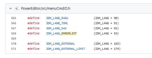

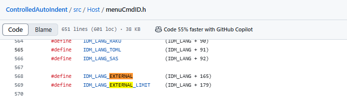

                                            PeterJones @Coises
                                            @Coises said in Config Files Need Updating, Too:
                                            I guarantee it is not: it is a standard Lexilla lexer. Did you update your menuCmdID.h file which defines the external lexer constants?
                                            No, it doesn’t look like you have:
                                            But since it’s IDM_LANG+93 vs IDM_LANG+165, and you shouldn’t be looking at the IDM, that’s not the likely culprit (though something you should still fix)
                                            Ah, searching for external in your plugin:
                                            it’s using the L_xxxx enumeration values from the Notepad_plus_msgs.h::LangType enumeration
                                            And that makes sense: Don chose to use whatever the “last” enumeration value happens to be for L_EXTERNAL, which means that every time a new built-in language is added, all plugin authors who compare vs L_EXTERNAL must update Notepad_plus_msgs.h whenever N++ does, otherwise their comparison will be off for anyone using one of the newer lexers in the most recent N++.
                                            So definitely update menuCmdID.h and Notepad_plus_msgs.h, and then that comparison should not be true, and it won’t go into that section of code erroneously.
