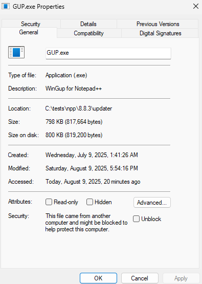

                            Ekopalypse
                            It looks like 8.8.2 is the last version that allows a portable version to use the plugin admin to install plugins, or am I the only one having this problem? With the newer versions you still see the dialog that Npp needs to be restarted but the restart or installation of the plugin does not take place.
                              PeterJones @Ekopalypse
                              @Ekopalypse said in Notepad++ v8.8.4 Release Candidate:
                              I concur. I saw it yesterday with DSpellCheck on 8.8.3, but thought it was just that one plugin, and didn’t look into it more deeply. I confirmed today with 8.8.3 portable and 8.8.4-RC portable that I cannot get DSpellCheck or ConfigUpdater or CollectionInterface plugins to install through Plugins Admin. (And confirmed that v8.8.2 portable is able to install plugins using Plugins Admin)
                              Looks like a regression in v8.8.3 that wasn’t noticed.
                              EkopalypseE 1 Reply Last reply Reply Quote 3
                                Ekopalypse @PeterJones
                                its blocked
                                unblocking it solves it.
                                PeterJonesP donhoD 2 Replies Last reply Reply Quote 4
                                  Confirmed.
                                  For future readers: you can also unblock the zipfile before unzipping, then none of the executables will be marked as “blocked” when they are extracted.

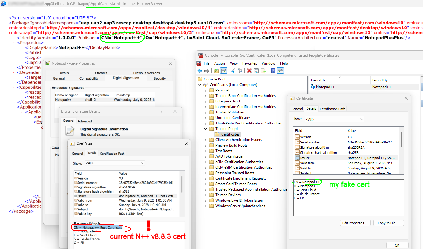

                                    xomx @donho
                                    @donho said in Notepad++ v8.8.4 Release Candidate:
                                    NppShell.msix is not signed either, because of signing error for unknown reason.
                                    Probably because of:
                                      donho @xomx
                                      @xomx
                                      It should match certificate’s Subject, not Issuer. (the issuer of the old certificate was DigiCert).
                                      I’ve checked your “home-mde” certificate comes with NppShell.dll (Thank you BTW), the content of both issuer and subject is identical.
                                      So with the new self-signed certificate, we need to add E=don.h@free.fr, at the begining.
                                      However, I still have signing problem:
                                      SignTool Error: An unexpected internal error has occurred.
                                      Error information: "Error: SignerSign() failed." (-2147024885/0x8007000b)
                                      Could you pass me your command to sign NppShell.MSIX please?
                                        donho @donho
                                        With some searches, it seems that MSIX just cannot be signed by a self-signed certificate, a lot of ppl have the same issue:
                                        https://techcommunity.microsoft.com/discussions/msix-discussions/can-not-sign-the-msix-pacakge-with-self-signed-certificate/218928
                                        @xomx
                                        I’m really curious how did you made it.
                                        xomxX donhoD 2 Replies Last reply Reply Quote 0
