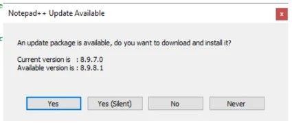

      1. When this pops up you MUST interact with it and it blocks you from doing anything else.
      1. Accidentally clicking OK because you were looking away and hit enter for new line takes you through the FULL install all questions. That is super disruptive!

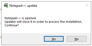

      2. Clicking Yes (Silent) gets you this in a couple seconds. Again you must interact with this dialog and it prevents you from doing anything else.
      1. Saying YES to this prompt will close the entire app. Changes will not be saved to disk for files you are working on, but will be stored to be saved later.
      2. Bonus; Saying NO to this prompt will bring you back to step 1 next time you use the app. I already OK’d the update, just do it the next time I use it.

        Most of your complaints can be addressed by: Settings > Prefereences > MISC > Auto-updater, set to Enable on Notepad++ Exit. That way, it will be as you are exiting the program, after everything is properly saved, not disrupting your workflow. All you have to do is answer “Yes (Silent)”, and since it will be closing Notepad++ anyway, there shouldn’t be the extra prompt of “updater will close it” because it’s already being closed.
        Also, after update is applied, it won’t check again for another 2 weeks, and usually there will be more than a month between new versions being triggered for auto-update, so it will only annoy you once every month or two.
