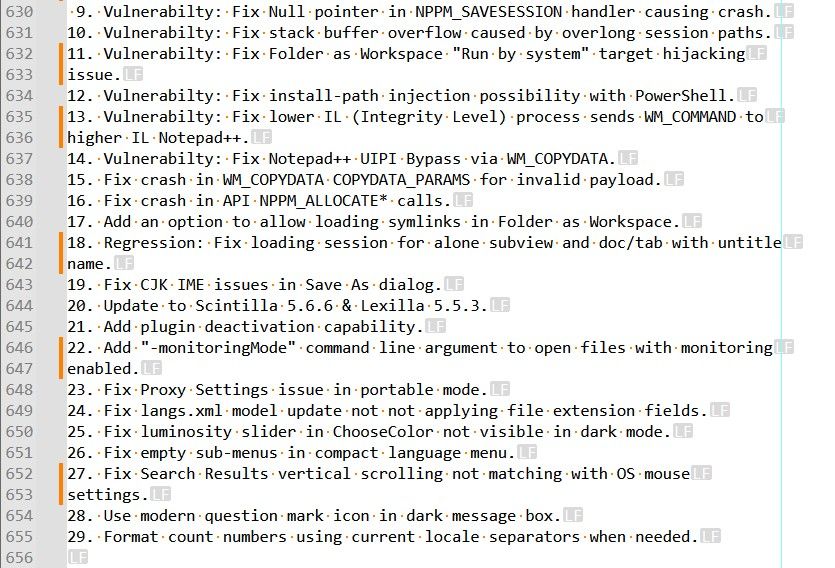

      And indeed, the New_LF_ANSI.txt file better respects the 78 limit than the Old_LF_ANSI.txt , as shown below :
      BEFORE :
      And
      AFTER :
      And

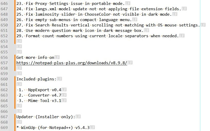

      Here is a screenshot of the resulting file, showing the end of the license.txt section and the beginning of the change.log section
      As you can verify, the reading of this text is rather painful :-((

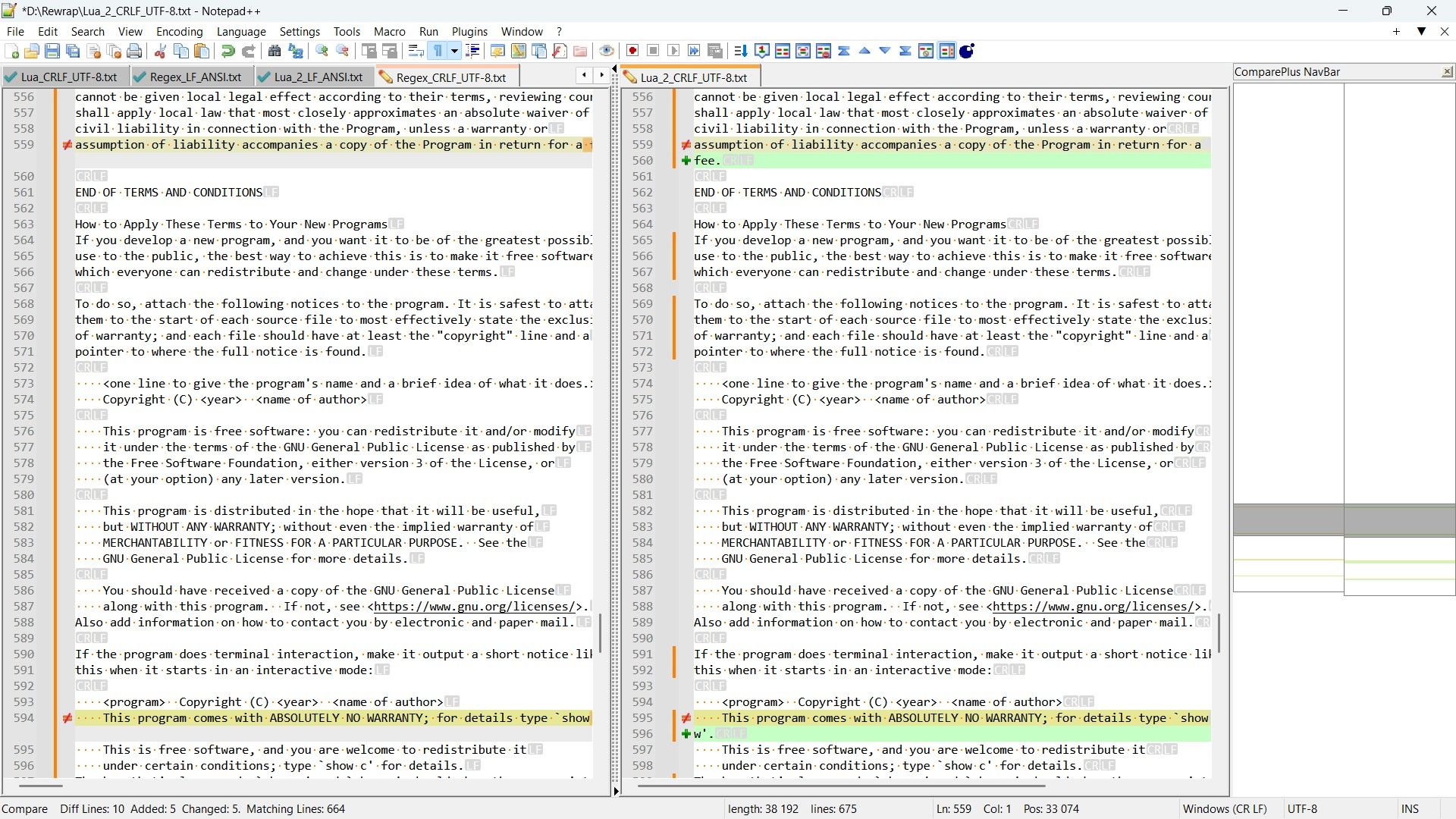

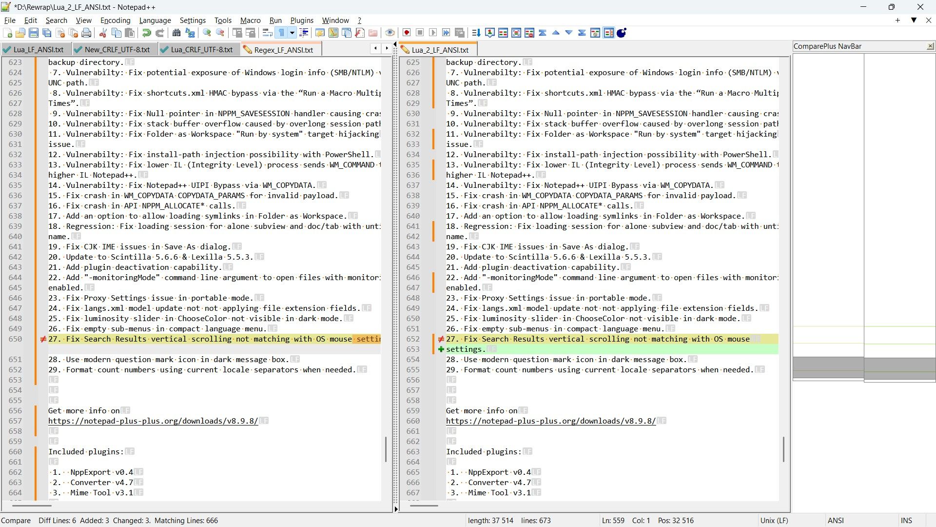

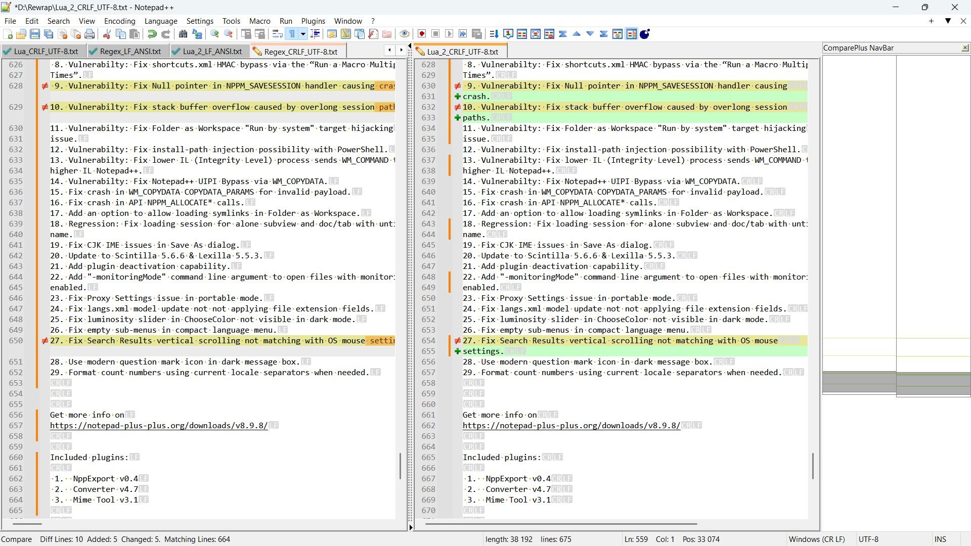

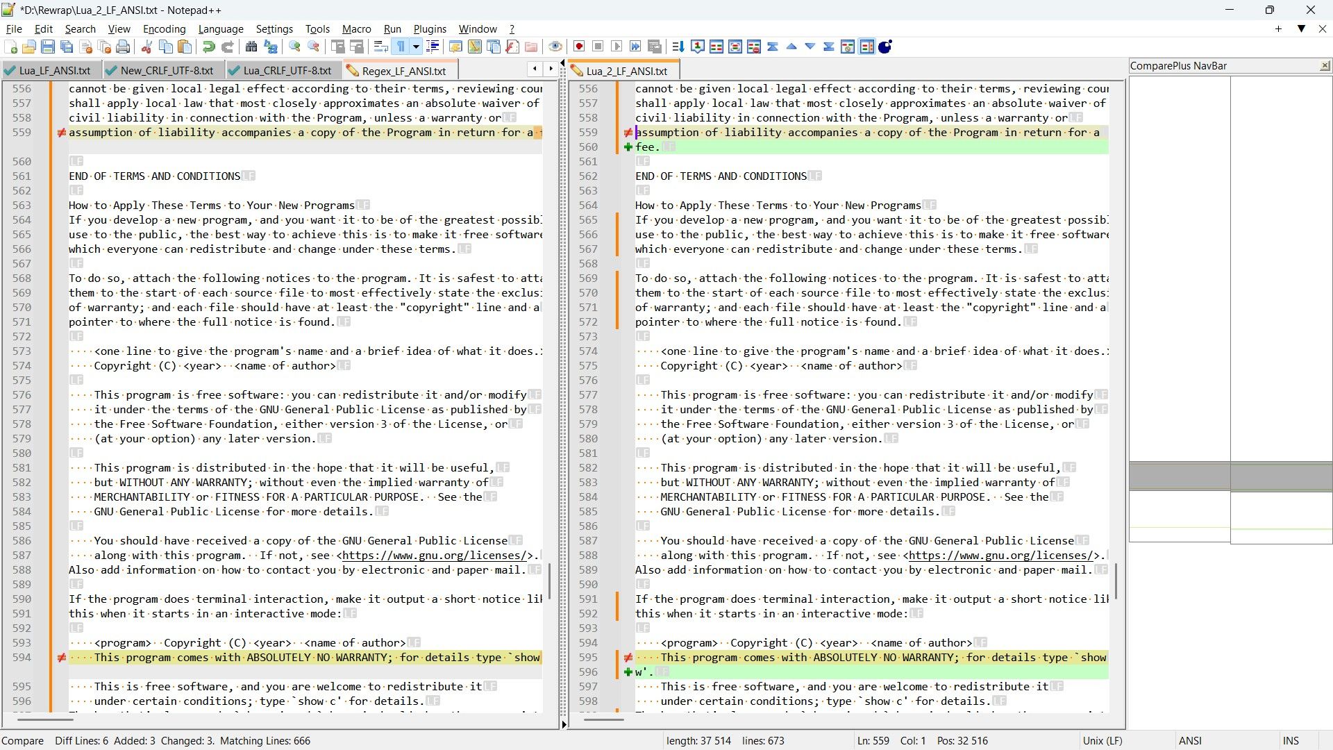

                  So, these four files showed an orange change history color. As you can see on the screenshots, the regex process acted on all lines, but some empty line endings, and your lua script just acted on lines which need wrapping !
                  Regex process :
                  Lua process :
                  However, the comparisons between the regex process and the Lua process shows the same number of differences ( 3 for ANSI files and 5 for UTF-8 files )
                  • Between ANSI files :
                  • Between UTF-8 files
