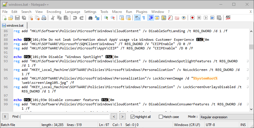

                      • asvcA Offline
                        asvc
                        I have created feature request at GitHub — https://github.com/notepad-plus-plus/notepad-plus-plus/issues/8278
                        @cmeriaux , I have experienced a few bugs, not sure if these are unique to my configuration yet:
                        1. Using “Highlight All” makes N++ scroll the viewer despite that valid match is already present on the screen:
                          animation
                        2. Not all matches are highlighted. Testing on the following snippet:
                          	"guid": "{xx-xx-xx-xx}",
                          	"name": "Command Prompt",
                          	"commandline": "cmd.exe",
                          	"icon": "ms-appx:///ProfileIcons/{xx-xx-xx-xx}.png",
                          	// "colorScheme": "Campbell",
                          	"antialiasingMode": "cleartype",
                          	"closeOnExit": "graceful",
                          	"cursorShape": "bar",
                          	"fontFace": "Consolas",
                          	"fontSize": 10,
                          	"hidden": false,
                          	"historySize": 9001,
                          	"padding": "8, 8, 8, 8",
                          	"snapOnInput": true,
                          	"startingDirectory": "%USERPROFILE%",
                          	"useAcrylic": false
                          Only the first one is highlighted and only two matches are highlighted after pressing “Enter”:
                        Will continue using this build and report back if more bugs are found.
