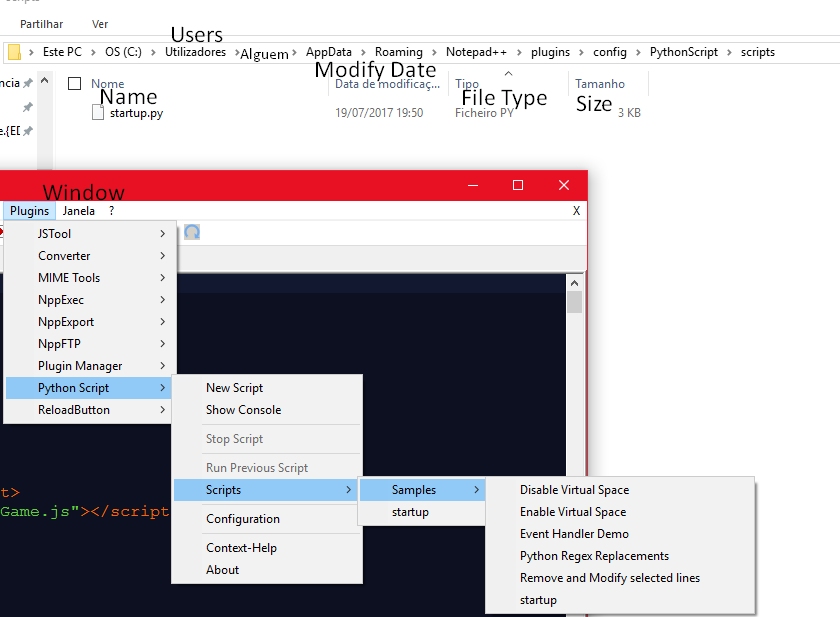

      C:\Users\Alguem\AppData\Roaming\Notepad++\plugins\Config\PythonScript\scripts
      how could this be, mine is pointing to
      C:\users\linus\Application Data\Notepad++\plugins\Config\PythonScript\scripts
      Has this changed with windows 10??
      Isn’t Application Data the same as AppData?
      And %APPDATA% always redirected me to \AppData\Roaming.

      I can use WINDOWSKEY+R instead, which opens the Run window, or I can use the search menu on Windows 10. Typing %APPDATA% both opens …\AppData\Roaming\.

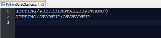

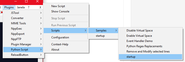

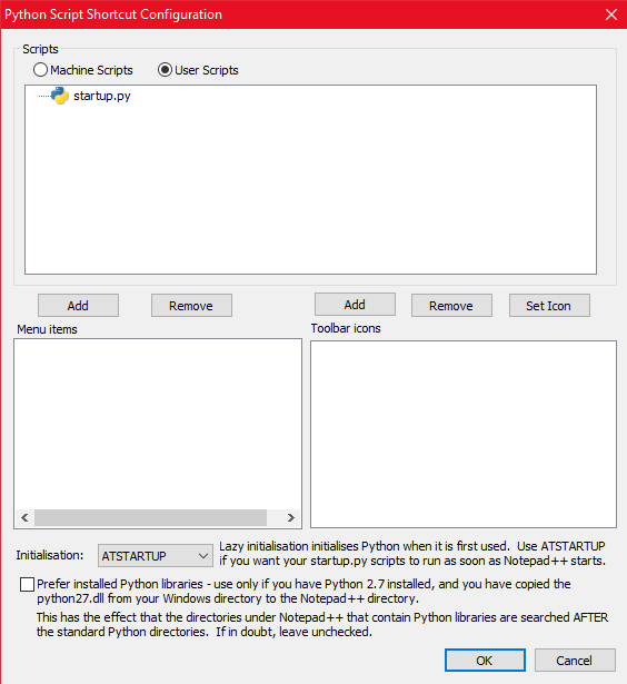

          One thing to note is that when I go to Python Script configuration it shows startup.py as a User script:
          Adding it to Menu items makes it show at Plugins>Python Script> startup.py.
