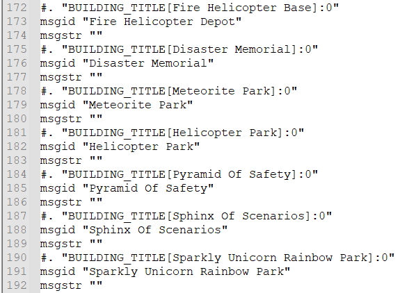

              I’m translating a game. I will translate simple words but I need to translate at least 1500 lines. A copy of the content I will translate is in the image below.
              I’ll just translate lines that start like (msgid “XXX”). So I just want to select all these lines and copy them to a separate place. Since each line starts with the same word + space + quotation mark, I thought it would be easy to select these lines. The problem is just that. It is very difficult to select 1500 lines one by one because there are different lines in between.
              I hope the translation and sentence structure is correct this time.
                If you do the marking operation followed by bookmarked lines copy that Peter describes, what you want should be easy to achieve.
                You’d do the marking operation with this setup:
                So that the Find what text is copy/pastable, here it is: ^msgid "

                  It still only selects (msgid ") this part and copies it. I can’t select the rest of that word on any line at once.

                    Start with:
                    Run the marking operation I described, to obtain:
                    Run this menu command:
                    Create new tab (press Ctrl+n) and past (Ctrl+v) to obtain:
                    Is this not the desired result?
                    And, this is absolutely no different than Peter’s earlier advice.
                    darkenbD 1 Reply Last reply Reply Quote 1
                    • darkenbD Offline
                      darkenb @Alan Kilborn
                      @Alan-Kilborn The bookmark menu worked. It’s exactly what I wanted, thanks…
