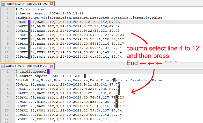

            I know I’m late to the discussion, but wouldn’t it be better to cancel multiline selection on cursor up and cursor down? 🤔
            So keep the “cursor left” and “cursor right” as-is, but remove cursor up down from the “Column Selection to Multiline editing” behaviour. I mean I can see how moving the multiline-select in certain ways is useful, but I don’t quite understand the practical use-case for keeping the multiline selection when moving up or down:
            • Cursor left/right = adjust multiline column position, skip existing column characters when editing etc.
            • Cursor up/down = …?
            • End key = Use multi-select to quickly add quotes or comma’s at end of lines with irregular lengths (JSON editing for example)
            • Home key = Same as left but faster, jump to the start of long lines, re-align column multi select etc.
            For example I can change all patient IDs from 001KUL to 05-001 using the multi-select and cursor left/right, see screenshot below. But when I start using cursor up and cursor down the multi-select becomes this weird situation. For example, when I move the multi-line selection up to beyond the start of the file and then press left/right then the first line has 2 cursors blinking(?).
            notepad_multi_selct
            I know the I can cancel the current multilines selection with the Esc key, or disable moving the multiline entirely in Preferences -> Editing 2 -> Enable Column Selection to Multi-editing -> uncheck.
            But in what situation is moving the multiline-select up and down useful? Wouldn’t you have to make a new multiline-select in most of those cases anyway?

                A slightly “better way” is available via the settings under Preferences / Editing 2 / Multi-Editing. Turn off the option Enable Column Selection to Multi-Editing.
                When you do that then:
                • Left/right arrow keys keep the multi-cursor mode intact. It gets a strange when one or more of the cursors goes of the end of the line as the cursor(s) wrap to the next line.
                • Up/down arrow keys cancel the multi-cursor mode and you have one cursor either on the line above or below where the multi-selection was.
                • The End key unfortunately cancels the multi-cursor mode. Snapping all the cursors to the end of the lines seems useful. One issue with this is that you can have more than one cursor on a line. Should End put all of them at the end of the line or should it delete the surplus cursors?
                • At present Home is like End in that it ends multi-cursor mode. With a standard single cursor Home looks to see if the line had leading spaces or tabs and Home jumps to the first visible character. You tap Home again and it goes to the start of the line. If we remain in multi-cursor mode to we want the various cursors to do this leading space thing?
                Something else to consider is Ctrl+Left arrow and Ctrl+Right arrow. Those do word jumps in single cursor mode.
