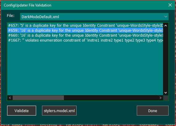

                          Just curious. Files that are flagged as invalid, what’s the recourse desired? I thought using the Validate Files would correct whatever was found after running ConfigUpdate that flagged those files and lines in the log.
                          I have two showing up:
                          One in stylers.xml
                          --- ConfigUpdater run at Friday, July 4, 2025 4:55:40 AM
                          --- Checking Styler/Theme File: 'C:\Users\camilee\AppData\Roaming\Notepad++\stylers.xml'
                          + LexerStyles: Sorted LexerType elements alphabetically (keeping "searchResults" at end)
                          ! Validation of C:\Users\camilee\AppData\Roaming\Notepad++\stylers.xml failed on line#1685:
                          XML validation FAILED: '2' is a duplicate key for the unique Identity Constraint 'unique-WordsStyle-styleID'.
                          Line#1685:
                                      <WordsStyle bgColor="FFFFFF" fgColor="000000" fontName="" fontSize="" fontStyle="0" name="COMMENT LINE" styleID="2"/>
                          …and a multiple fail in DarkModeDefault:
                          --- Checking Styler/Theme File: 'C:\Users\camilee\AppData\Roaming\Notepad++\themes\DarkModeDefault.xml'
                          ! Validation of C:\Users\camilee\AppData\Roaming\Notepad++\themes\DarkModeDefault.xml failed on line#657:
                          XML validation FAILED: '5' is a duplicate key for the unique Identity Constraint 'unique-WordsStyle-styleID'.
                          Line#657:
                                      <WordsStyle name="EVENT" styleID="5" fgColor="8CD0D3" bgColor="3F3F3F" fontName="" fontStyle="1" fontSize="" keywordClass="instre2"/>
                          --- Checking Styler/Theme File: 'C:\Users\camilee\AppData\Roaming\Notepad++\themes\MyDarkModeDefault.xml'
                          ! Validation of C:\Users\camilee\AppData\Roaming\Notepad++\themes\MyDarkModeDefault.xml failed on line#652:
                          Line#652:
                                      <WordsStyle bgColor="3F3F3F" fgColor="8CD0D3" fontName="" fontSize="" fontStyle="1" keywordClass="instre2" name="EVENT" styleID="5"/>
                          There are others for DarkMode as shown in this partial shot of the Validate box since I can’t screenshot the whole text since the box isn’t wide enough and it can’t be copied for inclusion in here under code format.
                          I see that double clicking the line, takes me to the file, and then I can double click the FunctionList view that leaves me on and that will bring up the line in the file, but the question remains…what am I supposed to change it to, or am I supposed to change it at all?
                          My viewing the new aspects made me believe the validation and correction was automatic by clicking those functions along with the Download new models. I fear I may just not know what these new capabilities are supposed to perform, so I don’t want to assume what they are supposed to do. Guidance?
                            PeterJones @Lycan Thrope
                            @Lycan-Thrope said in Config Files Need Updating, Too:
                            My viewing the new aspects made me believe the validation and correction was automatic by clicking those functions … Guidance?
                            Sorry, I was hoping the section on Validation in the README would be enough. I guess I need to add a help button and see if I can explain things better.
                            The validation has occurred, and it has found errors.
                            Unfortunately, I cannot program enough intelligence into the plugin to be able to figure out the right/best way to fix the problems, so it does not correct errors for you. That’s why the double-click will take you to the right spot in the problematic XML file. Further, the stylers.model.xml button can be used to open the model file side-by-side with the problematic XML – and the plugin will do its best to align the model file so that it’s showing the same section of its XML as has the problem in the other (though, looking at the order that line#652 is listed, I think my alignment algorithm might need some work: that line proved assumptions wrong).
                            You are then supposed to compare the two, and use the semi-understandable XML error messages to help you figure out… Maybe I’ll have to figure out a way to convert the errors that the validation library spits out into something more human-readable.
                            • '5' is a duplocate key... indicates that there are two <WordsStyle> entries that have the same StyleID. StyleID must be unique for Notepad++ to be able to correctly map that row in the XML (or that entry in the Style Configurator’s Styles: list) to the underlying Lexilla style. When there are two with the same StyleID, Notepad++ only picks one to show in the Style Configurator and send to Lexilla. So you need to compare your XML with the model XML, and figure out what the right solution is:
                              • Do you just need to pick one of the two duplicates and delete it (and if so, your human intelligence is needed to decide which is the right entry to keep and which to delete)
                              • Or does one of them have the wrong styleID, and you just need to change it to a different value
                            • '' violates enumeration constraint... indicates that you have a keywordClass attribute on your <WordsStyle> that has an invalid value (in your case, the empty string). keywordClass needs to be one of the known types as listed in the error message, or the attribute needs to not exist at all.
                              • You need to compare the failing XML to the model, and need to figure out what value of keywordClass should be there – or whether to delete the attribute altogether (if it’s not there for that styleID in the model)
                            The Download Newest Model Files grabs the most recent stylers.model.xml and langs.model.xml from the Notepad++ repo, and overwrites your possibly-out-of-date models. This will make sure that the model used when validating is the “current best practice” found in the repo. (I really thought that the README was clear on that one. Is it not?)
                            Created issue #23: I’ll see if I can get Ctrl+C and/or dialog resize to work. (I’ve never done either from C++; I really don’t have a lot of GUI-programming experience, so I’ve always started with “functional enough GUI for me to do what I want” for my plugins, without aiming for super-fancy features.)
                            • Lycan ThropeL
                              Lycan Thrope @PeterJones
                              @PeterJones ,
                              After this review by you, and again, re-reading the readme file you linked, it became much clearer. I admit to having only a cursory knowledge of the xml files in reference to how they relate to the Language and stylers that are usually controlled by the dialogs, so I was a bit lost about what they were highlighting and I think that’s where most of my confusion was. I’ve learned a bit more with this help you’ve given.
                              After reading the more detailed description you gave, and also, I hadn’t realized that the *.model.stylers.xml file button became enabled only after selecting and double clicking the error, that it could then open the model file, so that they could be compared. I think I was kind of lost with the new whizbang options.
                              I’m sorry if my head is thicker than it needs to be when it comes to noticing and using the new stuff…but the thicker head helps when I hit my head a lot, to make sure everything stays inside of it, mangled though it may be. :-)
                              I got it now. Thanks.
