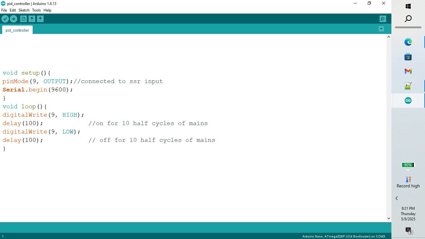

      Hi, I have a file in the app called pid controller. Some characters are in color. Can I get my printer Epson XP-2200 to print as shown in my document?
      I am attaching a copy of my file.

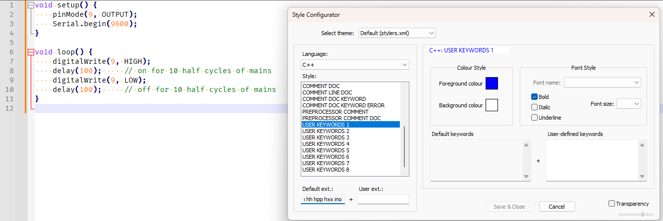

        Notepad++ will print in the syntax highlighted colors you see in Notepad++, depending on Settings> Preferences > Print. But your screenshot was not of Notepad++, so this isn’t the place to ask questions about Arduino IDE
        In Notepad++, you might have to go to the Style Configurator, C++, and set user extension to ino to get it to recognize Arduino source code.
          Additional info:
          First, once I was on my computer this morning, I was able to confirm that ino is already in the default list of extensions for C++, so you don’t need to add it to user ext. Sorry for my poor memory.
          Notepad++, by default, doesn’t know the Arduino-specific keywords/constants. But the Style Configurator has 8 “USER KEYWORDS #” styles for C++, and you can add your own keywords into User-defined keywords box for each, and define your own colors.

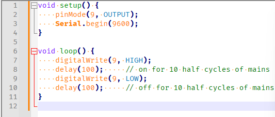

          Before:
          After:
          • Change USER KEYWORDS 1 to green, with setup loop
          • Change USER KEYWORDS 2 to orange, with pinMode digitalWrite delay begin
          • Change USER KEYWORDS 3 to bold+orange, with Serial
          • Change USER KEYWORDS 4 to aqua, with HIGH LOW OUTPUT
          You would have to go through and figure out any other keywords (I don’t currently have a list of arduino keywords, though you could probably search the forum for “Arduino” and maybe find something).
