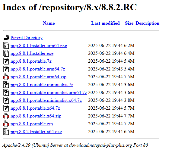

          PeterJones @donho
          @donho said in Notepad++ v8.8.2 Release Candidate:
          Notepad++ release candidate 8.8.2 is available here:
          http://download.notepad-plus-plus.org/repository/8.x/8.8.2.RC/
          The names of nearly all the files are wrong (still saying 8.8.1)

              donho @PeterJones
              I forgot to rebuild x86 & arm64 Notepad++, hence the wrong version value.
              It’s fixed now.

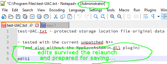

                                    xomx @donho

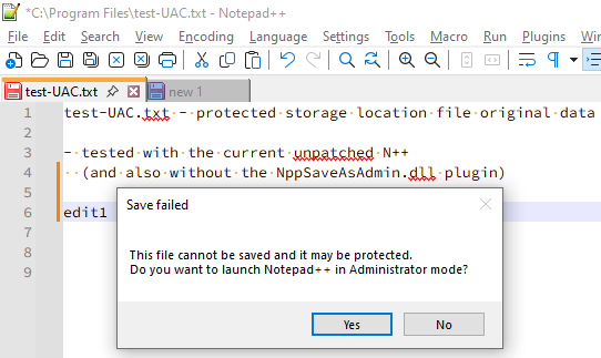

                                    1. Add feature to set read-only attribute on file so user can toggle (set/remove) read-only attribute of a file.
                                    Just fixed one (probably long standing) related issue:
                                    fix toggleReadOnlyFlagFromFileAttributes when invalid file attribute(s) or insufficient user rights #16733
                                    (for STR just create with admin-rights e.g. C:\Program Files\test-RO.txt file and set its R/O-attribute, then open it as a non-admin in N++ and try to toggle (in older N++ use the “Clear Read-Only Flag” menu item) that read-only file attribute, then check it in Explorer or simply Alt-Tab from/to N++ and see that the tab R/O-state is back as the file read-only attribute removing failed due to insufficient rights…)
                                      donho @xomx
                                      @xomx
                                      Merged into master now. Thank you.

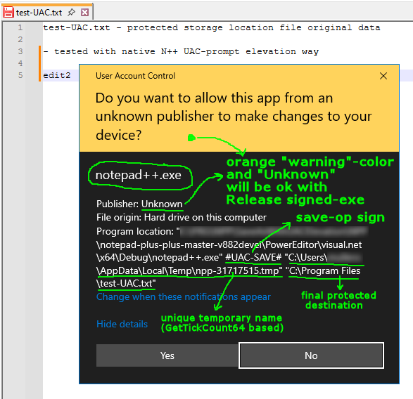

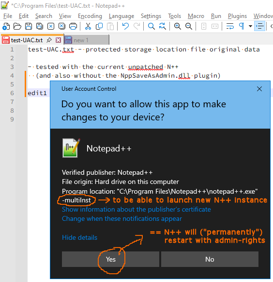

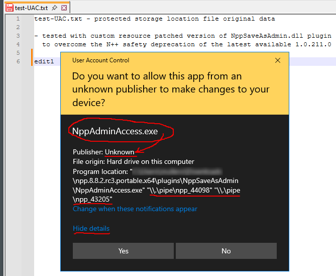

                                        xomx @donho
                                        I will add the warning message
                                        Ok.
                                        Just FYI - I have in progress (so far so good, I’m already using it, it just needs to be tested more) a native N++ replacement for the deprecated NppSaveAsAdminPlugin. My concept used there will allow an easy addition of another N++ ops requiring the UAC-prompt elevation. That’s why I left this comment in my above fix when the SetFileAttributes failed - // probably the ERROR_ACCESS_DENIED (5) (TODO: UAC-prompt candidate).
                                        One more thing - I don’t think I would be the only one here who would offer to share the costs of getting the new certificate so that you don’t have to finance it only yourself. Just say so if needed.
                                        donhoD 1 Reply Last reply Reply Quote 6

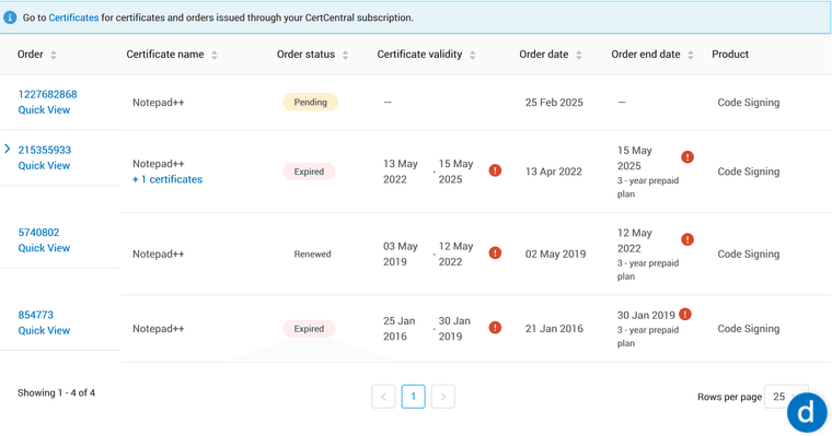

                                            Thank you! And thank you guys willing to contribute to the cost of the new certificate!
                                            In fact, before leaving X, I tweeted about the certificate expiration issue, and DigiCert (I believe someone from their market team) has responded positively, offering a free of charge certificate.
                                            Thanks to their generosity, I haven’t had to pay for a code signing certificate in the past 9 years:
                                            However, the validation process is another story. It’s not the first time the name “Notepad++” has been rejected - I do understand the validation team’s position. But every single time I have had to communicate, negotiate, beg or/and shout on Twitter to gain a certificate issued under the name “Notepad++”. This circle repeats every 3 years, and frankly, I’m getting tired of it.
                                            So thank you again for your kind & noble offer. Even if I had to pay for the certificate, it’s not about the money - it’s about signing our code under the name “Notepad++”. I believe we at least deserve that much.
                                            xomxX 2 Replies Last reply Reply Quote 6
