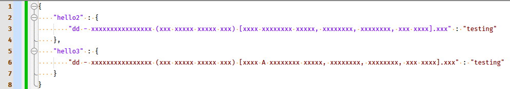

      I have some data in .json file, that as far as I can tell is valid (i.e., processes for me with Python using the json library).
      Anyway, Notepad++ seems to syntax highlight it wrongly in certain cases – I’m wondering if others have such experience…
      Here’s an example:
          "hello2" : {
              "dd - xxxxxxxxxxxxxxxx (xxx xxxxx xxxxx xxx) [xxxx xxxxxxxx xxxxx, xxxxxxxx, xxxxxxxx, xxx xxxx].xxx" : "testing"
          "hello3" : {
              "dd - xxxxxxxxxxxxxxxx (xxx xxxxx xxxxx xxx) [xxxx A xxxxxxxx xxxxx, xxxxxxxx, xxxxxxxx, xxx xxxx].xxx" : "testing"
      When I put this into a Notepad++ (8.8.3) tab that has its language set to “JSON file”, it looks like this for me:
      I would expect that line 6 is colored like line 3, but the addition of the space and the A in line 6 causes the coloring to change.
      • rdipardoR Offline
        rdipardo
        There’s a hard-coded limit of 100 characters for property names; the property inside “hello3” has 101. It’s a known issue.
