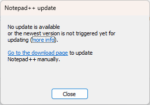

                I cannot replicate that. In v8.8.5, if I do ? > Upate Notepad++, I get the dialog telling me there is no updated available:
                Further, the really-old v8.5 (from 2023!) is not the most recent for auto-update: v8.8.3 is. There is no way that a recent ...Notepad++\updater\gup.exe would try to download v8.5 when starting from a newer version of Notepad++
                The update check DOES have logic that prevents it. When Notepad++ checks for updates, whether triggered by the auto-update or by a manual ? > Upate Notepad++, it actually sends the current version as a query parameter in a URL where it asks the server if there’s a newer version that has been triggered for auto-update. The answer it should be getting from v8.8.5 is “no”.
                If I take my v8.8.5 and edit config.xml using a separate program, so that I change the nextUpdateDate to be eons ago, like <GUIConfig name="noUpdate" intervalDays="15" nextUpdateDate="20050919" autoUpdateMode="1">no</GUIConfig> – then when I start Notepad++, it checks for an update, and sees that v8.8.3 on the server is older than v8.8.5, and does not ask me to upgrade. Similarly, the same date value but autoUpdateMode="2", it won’t check when I start Notepad++, but when I exit Notepad++, it will wait to do the update check but it still finds no newer version, and properly does not update.
                There is nothing that I can do to convince my v8.8.5 to try to “update” to v8.5 from 2023, whether triggering a manual update check or forcing it to check on app start or forcing it to check on app exit.

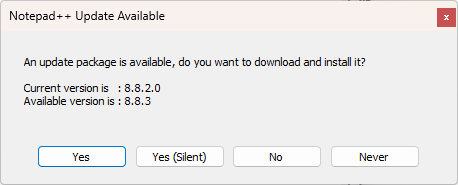

                  @Adam-Fradley ,
                  Further, if I start from an 8.8.2 portable, with the config.xml modified per my previous explanation, it does see the new version, and says,
                  But it DOES NOT start downloading unless you tell it to.
                  If you are not getting that dialog, then it’s not Notepad++'s gup.exe updater that is trying to do the download, and you need to look for your culprit elsewhere.
