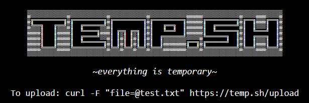

                t e m p . s h seems to be a kind of non-permanent storage, anyone can use it:
                Notepad++ doesn’t distribute/use curl.exe binary, it uses the curl-library functionality via “C:\Program Files\Notepad++\updater\libcurl.dll” for the N++ updater GUP.exe. And of course N++ never uses such an anonymous storage place.

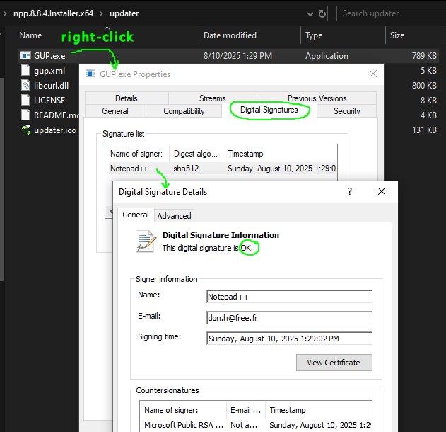

                Also you should check the digital signatures of your N++ binaries like:

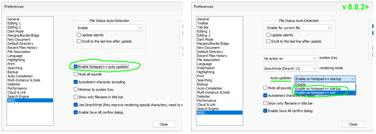

                                • when that installed N++ app is launched after a predefined period of time (I think, the default is 14 days), it issues a net-request to the N++ (compromised) server about a possible newer version than the current X.Y.Z and gets a response (yes/no, together with a link to the possible new updated binaries/installer)
                                • then the app is being updated (at exit or start of the N++ app, see the setting pics below)

                                  Only the users with this N++ setting ON could be affected:
                                  and only if there was at least one real N++ version auto-update in the attack-window (Jun 2025 - 2nd of Dec 2025, which means N++ updates to v8.8.2 - v8.8.8). Note that N++ binaries (installers and portable archives) have not been compromised at all, they reside at the GitHub https://github.com/notepad-plus-plus/notepad-plus-plus/releases/
