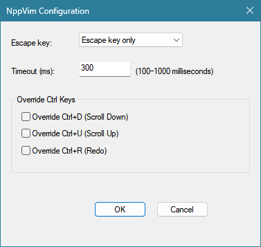

          • Thorsten HeuerT Offline
            Thorsten Heuer @h-jangra
            @h-jangra Bild1.png I apologize, but I can’t find a way to set “:set tw=60 and :wrap or gq” in “NppVim”. I’m not a very experienced user; perhaps I’m missing some basic knowledge.
            h-jangraH 2 Replies Last reply Reply Quote 0
            • h-jangraH Offline
              h-jangra @Thorsten Heuer
              @Thorsten-Heuer You can set the text width in command mode by typing :set tw=80. This defines an 80-column wrap limit.
              After that, use V to select the line (visual line mode) and press gq to reflow it according to that column width.
              Currently, this setting isn’t persistent between sessions. If you’d like it to be configurable (similar to Vim), feel free to open an issue, I can look into adding support for it.
