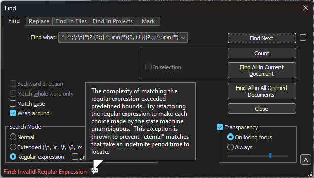

        When I ran your regex when there are no matches, it told me the complexity was too great
        – that’s generally an indicator that your * are requiring there to be too many backtrack events. And that’s a function of your exact memory and resource allocation and other such things that cannot be documented as “there is a hard limit at XYZ”.
        I then changed line 358660 to only go through ...;eleven;end and line 382650 to go ...;eleven;twelve;thirteen;end so that they should match. starting with caret at position 1 in the file, it was able to find both of those matches.
        I was hoping that adding the + to the * to make it “greedy” (which prevents backtracking) would make it more efficient, but when I had no matches in the file, it still said it was too complex.
        If I break it into ^[^;\r\n]*+(?:;[^;\r\n]*+){0,11}$ to find <12, and then ^[^;\r\n]*+(?:;[^;\r\n]*+){13} to find at least 13 (notice there isn’t the $ end-of-line… if you really want it to go to the end of the line, ^[^;\r\n]*+(?:;[^;\r\n]*+){13}(?-s).*+$ might be more efficient than {13,}, because after the thirteenth semicolon, it won’t care what characters come between there and EOL). And when I run each of those individually, they both catch what they are supposed to, and if I have a file that has only twelve-semicolon lines, neither finds anything and neither complains about the complexity. So you might want to see if breaking it into two regex instead of one will make it more reliable for you.
        My guess is that it was just too much backtracking. Though I’m surprised it just “fail to find matching text” rather than “gave an error”. Unless you just didn’t notice the error message.

            Now, as @peterjones mentioned, if the file contains only valid lines, oddly you get the error message The complexity of matching... ! And that’s why the @Coises syntax, using backtracking control verbs, is very useful.
