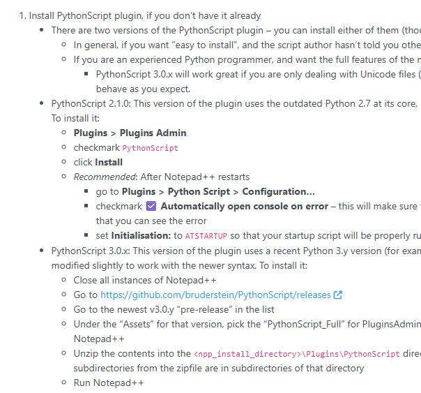

            In my last post, the word “FAQ” was a link which took you to the FAQ: How to install and run a script in PythonScript. If you didn’t notice that and click it, and instead had to actually read through the topic list in the FAQ, I’m sorry that you didn’t recognize a link in the post.

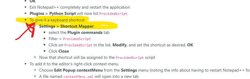

            Inside the PythonScript FAQ, which is the FAQ I linked you to, it’s called “keyboard shortcut”, not “hotkey”. Here’s a screenshot of the relevant piece of the FAQ:

            Nonsense. Read the FAQ. It’s quite obvious that the FAQ specifically mentions how to do it in both the PythonScript 2.1 and PythonScript 3.x. Here’s a partial screenshot of the FAQ showing how to install either:
            To get the full details, you will actually have to read the FAQ, because that’s the reason it was written; I shared this rectangular screenshot to prove my point, and encourage you to read the whole FAQ yourself.

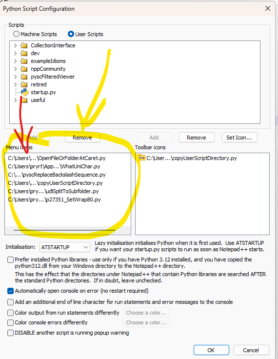

            Nonsense. This is my PythonScript Configuration menu for PythonScript 3.x, which is essentially unchanged from PythonScript 2.1’s Configuration menu:
            To add to the Menu Items list, you click the Add button over the Menu Items. It’s a very intuitive dialog, and that’s easy to understand.

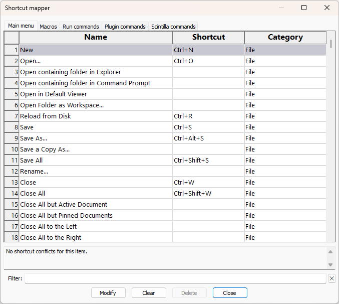

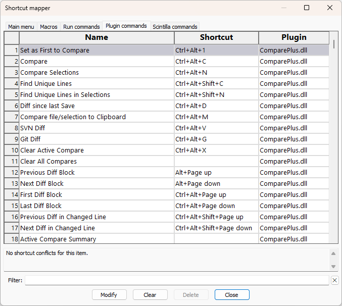

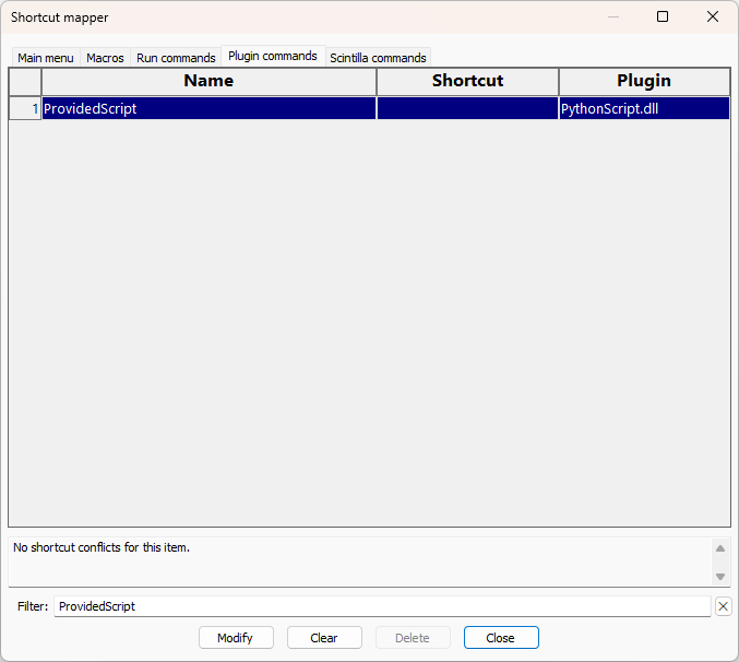

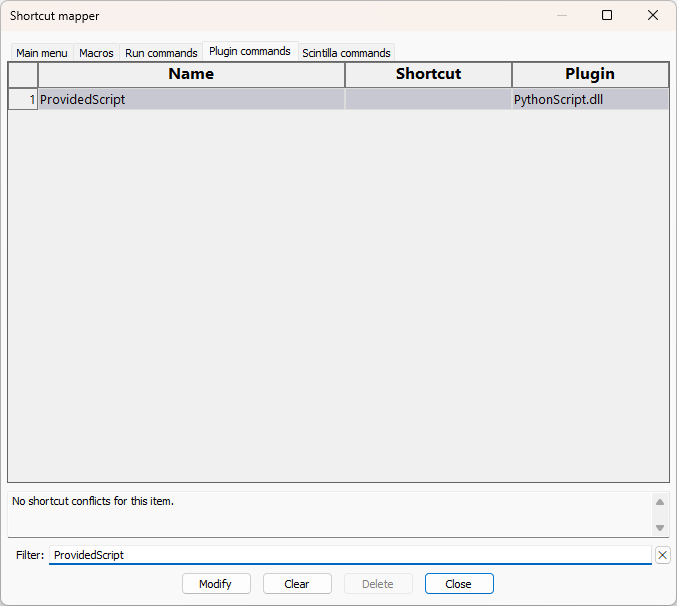

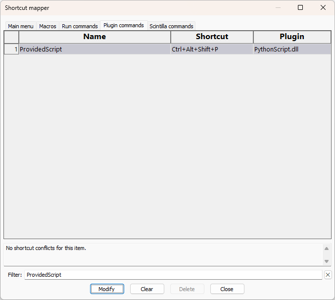

            Once you have placed the script in the menu, as explained in the FAQ, then you use Notepad++'s Shortcut Mapper (Settings > Shortcut Mapper) on the Plugin Commands tab of the Shortcut Mapper dialog. The FAQ explains this.

            As the FAQ explains: add the script to the menu, then use Notepad++'s Shortcut Mapper to assign the shortcut.

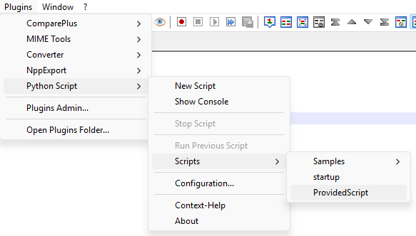

                  • you already have created the script, and it shows up in Plugins > Python Script > Scripts

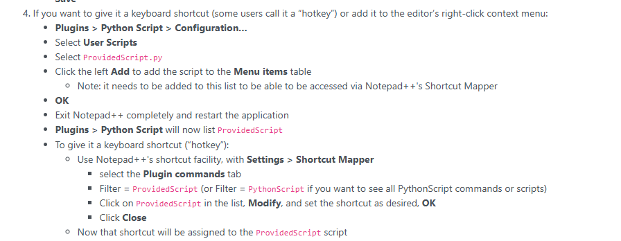

                  These are the instructions I am following from the FAQ:
                  The instructions, with screenshots:

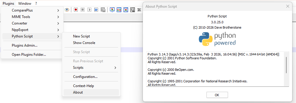

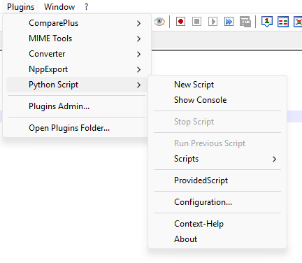

                  1. First, here is confirmation that I’m running PythonScript 3.0.25, based on a screenshot of PythonScript ABOUT box:
                    please show your ABOUT box if following these instructions do not work for you
                  2. This shows I have already created the ProvidedScript.py, and it is in my scripts menu, but not in the main PythonScript menu.
                    please show a screenshot of your Scripts submenu if these instructions do not work for you

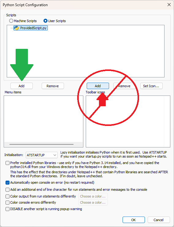

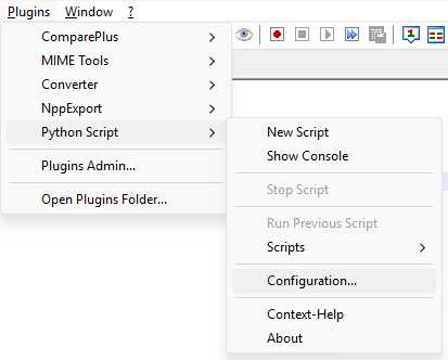

                  3. The FAQ instructions tell me to go Plugins >Python Script > Configuration…: I follow those instructions, and confirm the menu entry exists:

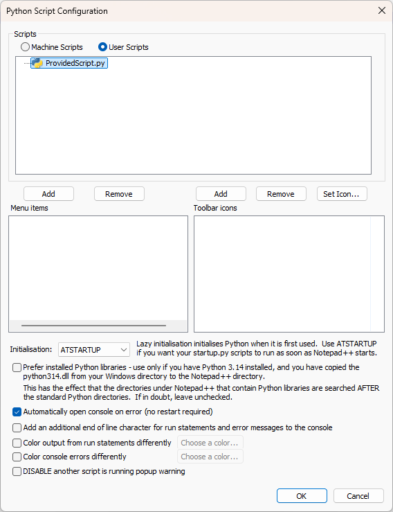

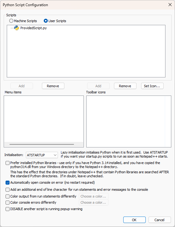

                  4. When I click that menu entry, I see the following dialog:
                    please show a screenshot of your Python Script Configuration dialog if these instructions do not work for you
                  5. The FAQ instructions tell me to pick User Scripts next. That is already selected, as shown in screenshot for step 4
                  6. The instructions tell me to select ProvidedScript.py. I click that, so it’s now got a highlight/selection bubble around it:

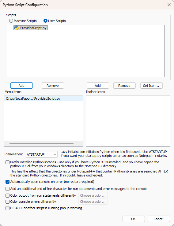

                  7. The instructions tell me to “Click the left Add to add the script to the Menu items table”. In this dialog, I see two Add buttons, so in the next step, I will click the left one: here is a screenshot with that button pointed to with a big green arrow. Do not click the one with the red arrow:
                  8. I follow the instructions to click the left Add button. Now the dialog has changed, to include my script in the Menu items list:

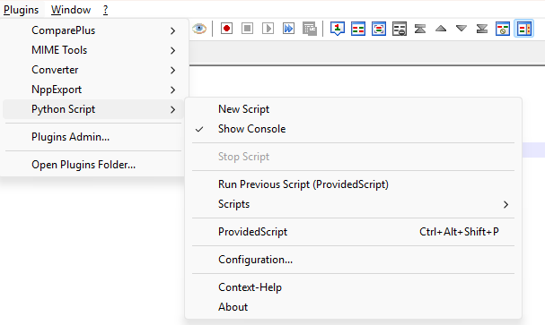

                  9. The instructions next say to click OK. I won’t supply another screenshot, as that button is easily findable.
                  10. The FAQ instructions tell me to “Exit Notepad++ completely and restart the application”. You have to do this in order for Notepad++ to be able to assign the keyboard shortcut. If you skip this step, the remainder of my instructions will not work. So I exit and restart Notepad++ (no screenshots)
                  11. The FAQ next says, “Plugins > Python Script will now list ProvidedScript”: here is a screenshot showing that is true for me:
                  12. The FAQ says to use Notepad++'s shorcut mapper using Settings > Shortcut Mapper. First, here is a screenshot of the menu, which includes that entry:
                  13. When I click that entry, I get the following dialog:
                  14. As the FAQ says, I next “select the Plugin commands tab”. In that dialog, I see “Plugin commands” at the top, so I click it, and see:
                  15. As the FAQ says, I next “Filter = ProvidedScript”. I see the Filter box in the dialog, so I type ProvidedScript there, and now see
                  Cool, I can see that ProvidedScript is available to the Shortcut Mapper with PythonScript 3.0.25 at this point. Making good progress.
                  If following these instructions is not working for you, please change the Filter to PythonScript, and then show a screenshot of your Shortcut Mapper dialog
                  1. The FAQ says, “Click on ProvidedScript in the list”, so I click on it. and can see that it’s been highlighted as active:
                  2. The FAQ instructs me to Modify, so I click that button, and a new dialog pops up:
                  3. The FAQ next says, “and set the shortcut as desired”, so I pick Ctrl+Alt+Shift+P:
                    if following these instructions is not working for you, please share the screenshot here, if you made it this far
                  4. The FAQ tells me that OK is next, so I click that, and it goes back to the full Shortcut Mapper dialog, which now shows that Ctrl+Alt+Shift+P is the shorcut:
                  5. At this point, the FAQ tells me that I can Close the dialog, so I do.
                  6. To check, I look at the Plugins > PythonScript menu again, and see that it now lists the shortcut next to ProvidedScript. Cool:
                  7. Finally, I do Ctrl+Alt+Shift+P, and it runs my script.

                    THANKS VERY MUCH for your VERY exhaustively detailed response. I DID as asked and didn’t involve the AI.
                    Step 1 - Confirmed I AM using 3.0.25.0
                    Step 2 - Confirmed Script Display plugins -> Python Script -> scripts
                    Samples
                    CollapseSelection
                    CollapseSelectionRest
                    startup
                    Step 3 - NOT confirmed plugins -> Python Script -> Configuration
                    DOES NOT LIST MY SCRIPTS… It NEVER has EVER in ALL my tests. My scripts DO NOT register…

                        I see “CollapseSelection” is one of your scripts. What is the full path of CollapseSelection.py? I am assuming that you have a normal installation, so it’s likely either in your c:\users\_____\AppData\Roaming\Notepad++\Plugins\config\PythonScripts\scripts\ directory, or in c:\Program Files\Notepad++\Plugins\PythonScripts\scripts . If it’s in the AppData, then I would expect to see it in the User Scripts selection in the PythonScript Configuration dialog, as the instructions say. However, if it’s in the Program Files directory, then it would be in the Machine Scripts section, so you would have to click that radio button to see the Machine Scripts, and then you could click on the script and continue following the steps from step 6.
                        Please also note: the FAQ that you have chosen to not fully read has a Footnotes section, and that section explicitly describes the difference between the User Scripts and Machine Scripts – and that Footnote #1 was referenced in the “new script” instructions. So if you had read the full instructions in the FAQ, then you would have seen there was a footnote while you created your script, and you would have seen that location of the script does matter. (And the fact that your AI didn’t tell you there were two possible locations, and know how to change the Configuration dialog from User Scripts to Machine Scripts to check that, once again proves it doesn’t actually know and understand the plugin.)
                        Louis WindsorL 1 Reply Last reply Reply Quote 1
                          Readers of this topic: I have been updating the FAQ as I see things that maybe were not 100% clear. Some improvements made (so far):
                          • added notes throughout explaining that the only differences between PythonScript2 and PythonScript3 procedures are for installation; everything else in the FAQ applies to both (despite false AI claims to the contrary)
                          • in the 2. Create a new script, mentioned both “user scripts” and “machine scripts”, and made sure the footnote was referened to explain the difference between them
                          • in the 4. If you want to give it a keyboard shortcut or add it to the editor's right-click context menu:
                            • add word “hotkey” to aid in people’s search
                            • restructure step 4 to have three main subpoints: prerequisites, keyboard shortcut / hotkey, and right-click context menu
                            • in the keyboard shortcut / hotkey section, explained that you might have to check both User Scripts and Machine Scripts in the configuration dialog, depending on where you saved the script (and reference the footnote, to give the details)

                            In fiddling around I copied the PythonScript directory from Program Files into AppData and TaDa! Everything fell into place… EVERYTHING WORKED like clockwork!
                            BTW ALL shows in Configuration NOW including Samples AND startup.py. AND Settings -> Shortcut Mapper work a treat and I built my hotkeys… 👏🙏👍

                              I asked for screenshots (a normal function of Windows, which I assumed you would know how to grab). I asked for the Debug Info (I told you what menu to go into to get it). You provided neither.
                              Also, I thought telling you that NOTHING showed in " -> Configuration" was self evident and DIDN’T need a screen snapshot?
                              The screenshot would have confirmed: 1) that there really was “nothing” there (maybe you and I have a different definition of “nothing”), 2) whether you had really selected “user scripts” or had selected “machine scripts”, and 3) that you were willing to follow instructions to try to get help.
                              I’m happy to announce I’ve fixed it!!! Don’t ask me how but my WHOLE NP++ setup was weird!!! It seemed half in Program Files and half in AppData.
                              That’s not weird. That’s how Notepad++ and PythonScript are intentionally set up. The FAQ footnote that I’ve begged you to read explains why there are the two different script locations.
                              You thus copied way too much.
                              You could have copied just the scripts. Or you could have just clicked the “machine scripts” button in the dialog, like I told you to, and not had to copy any files.
