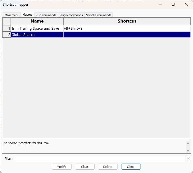

      When I tried the above I has 2 issues:
      1. I have a “shortcut"s”.xml, not a shortcut.xml file. I assume this was a typo??
      2. I was unable to create a shortcut for this Global Search, When I open the Settings > Shortcut Mapper… > Macros tab I get this result:
        I don’t see a Global Search line to double-click on.
        It’s there for me. Is the macro in the Macro menu yet? If not, did you remember to save the shortcuts.xml file and then exit Notepad++ and restart, because Notepad++ doesn’t re-read that config file for new macros when you save it: you have to exit the app and launch it again to have it reload the config files.

            I was trying to find this line: the line containing </Macros> in shortcuts.xml but did not see it.
            Looks like the updated XML libary that Notepad++ now uses is changing empty
                <Macros>
                </Macros>
            into
                <Macros />
            … which is valid XML, but annoying when people are trying to explain how to edit macros manually.
            To follow @guy038’s instructions, you will have to change
                <Macros />
            into
                <Macros>
                </Macros>
            and then put the macro inside it, like:
