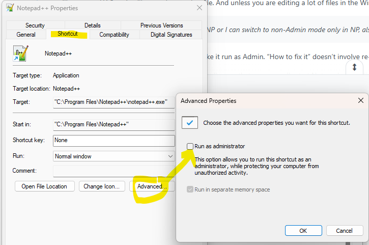

                    PeterJones @subodhjaiswar
                    I am only user using my system and I have the admin privilege as its needed for during my routine work.
                    Your account can have administrative privileges without running every application in Admin mode.
                    And, especially with Notepad++ v8.8.7, there is no reason to run Notepad++ “as Administrator”, because anytime that Notepad++ v8.8.6 or newer tries to save a file but doesn’t have permission, it will pop up a UAC, so it will properly save that file. And unless you are editing a lot of files in the Windows hierarchy, Notepad++ shouldn’t actually need UAC permission all that often.
                    Do I need as different method why installing NP or I can switch to non-Admin mode only in NP, also will non-admin mode allow software update/install.
                    You actually had to do something special to make it run as Admin. “How to fix it” doesn’t involve re-installing, though it might involve changing one or more shortcuts:
                    • If you have the N++ icon pinned to your toolbar, so that you normally start Notepad++ by clicking its icon on the same bar as the start menu and where the running programs are shown, you can right click on the icon, then right click on Notepad++ in that menu, then choose Properties, which will allow you to edit that shortcut’s properties. Click on Advanced… , and if Run as Administrator is checkmarked, uncheckmark it, then OK a couple times to get it to save.
                    • If you have the N++ icon on your desktop, so that you normally or often start Notepad++ by double-clicking on the desktop icon, you can right click on that desktop icon, choose Properties then Advanced… and if Run as Administrator is checkmarked, uncheckmark it, then OK a couple times to get it to save.
                    • If you usually use the the Notepad++ icon in the Start menu to run Notepad++, then you can right click that icon, Open File Location. In the folder that it pulls up, right click on the Notepad++ icon, choose Properties then Advanced… and if Run as Administrator is checkmarked, uncheckmark it, then OK a couple times to get it to save.
                    • If you usually double-click a file, and Notepad++ gets launched as a result, under normal circumstances, this should not run as Administrator. if it is, I am not sure how to fix it. (I thought there was a similar run-as-admin checkbox for the exe itself, but I cannot see it in the properties or advanced for the exe, so my memory is playing tricks on me)
                    So, if you aren’t able to get it to stop running in the Admin mode: ON (the title bar will also say [Administrator] at the end if it’s admin mode), then let us know which things you tried, and how Notepad++ is normally launched (whether by a shortcut, or double-clicking the file you want to edit, or whether Notepad++ starts when you boot Windows), and maybe someone else will remember how to turn it off for your specific circumstances.

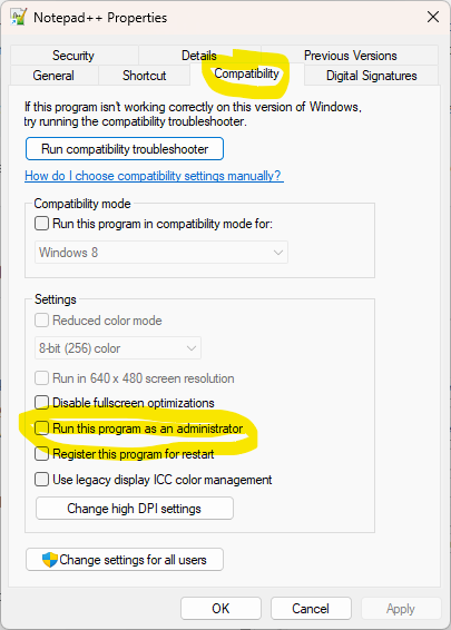

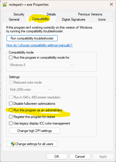

                    update: Ahh, if you go to the Notepad++ directory and right-click Properties on the notepad++.exe itself, it’s on the Compatibility tab of the dialog; and you can actually find the checkbox there for the shortcuts, too, instead of going to the Advanced… button.
                    exe properties > compatibility:
                    shortcut properties > advanced:
                    shorcut properties > compatibility:
