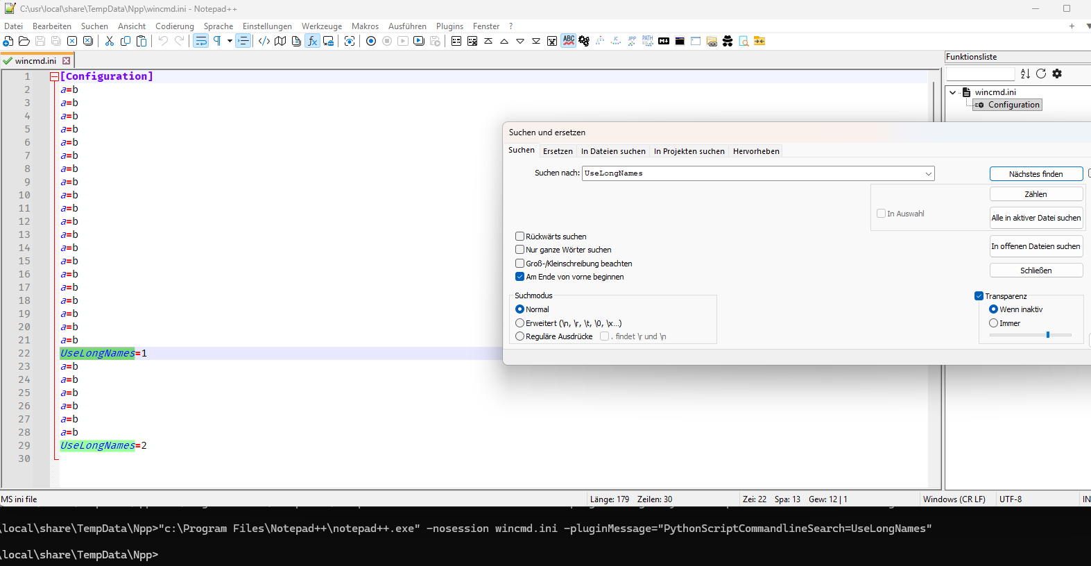

                Native2904 @PeterJones
                Thank you very much for taking the time, I really appreciate that!
                I was able to implement everything so far.
                I wanted to ask whether you wrote the script so that the search is executed automatically (i.e., the “Find next” button is pressed automatically) or if it only fills the search field with the “term”?
                For me, the term is only inserted, and I have to trigger the search manually (I’m not a programmer – please excuse my lack of scripting knowledge).
                  PeterJones @Native2904
                  @Native2904 m
                  For me, it clicks the Find Next. It worked with 100% of my tests. Are you using English localization (so the button is literally Find Next) or are you in a different localization?
                  And do you have the single button, like
                  or the two buttons with arrows?
                  Because it’s looking for exact button text when trying to figure out what to click; if it cannot find a button called Find Next, then it won’t be able to press it. So if there’s anything different from a default setup, my script will likely not work for you.

                      • N Offline
                        I only modified her script in such a way that I changed all the names that were different according to the pattern:
                        hFindBtn = FindWindowEx(hFindWnd, 0, "Button", None)

                        Gif_from_action_on_Screen_hosted_on_imgur
                        • N Offline
                          Native2904
                          Sorry, but in the GIF, Notepad** is already set to English; it was actually running in German until now.
                          I first need to get used to the editor’s rules as a new user.
                          I can no longer edit my first reply with the debug log.
                          I would like to correct myself: it’s only that one entry I changed.
                            @Native2904 said in How can I pass a search term to Notepad++ via command?:
                            Most likely, you’re just missing the & to indicate the underlines.
                            But assuming it’s the default German localization, I should be able to figure out what needs to be done, and post the edited version of the script.
                              @Native2904 ,
                              updated script:
                              # encoding=utf-8
                              """in response to https://community.notepad-plus-plus.org/topic/27472/
                              (fixed URL to Topic)
                              process -pluginMessage="PythonScriptCommandlineSearch=term"
                              `term` must be a normal search term, not a regular expression; it currently cannot include semicolons `;` or double-quotes `"`

                              When I have localization=Deutsch, I get:
                              The changes I made: I fixed the variable/function naming; I updated the window/button strings per german.xml localization file, and I added a wait-loop so if it takes a second or two for the FIND dialog to appear, it will try again rather than give up.
                                Thank you many times!
