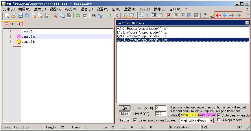

        I’m not familiar with that plugin. Do you have a screen shot or link to the exact functionality you are referring to?
        The only image I could quickly find regarding the location navigation plugin and margins is this:
        Scott SumnerS 1 Reply Last reply Reply Quote 0
        • Scott SumnerS
          Scott Sumner @dail
          @dail
          Your image shows the functionality. The marker on line 3 is an unsaved changed line and the marker on line 2 is a saved changed line. Ideally I’m interested in finding a short pythonscript example on how to do that sort of margin/marker manipulation.
