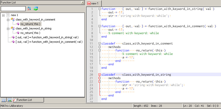

                        Hello @guy038 and @MAPJe71
                        Thank you for your answers, especially on Nested Pairs and recursion. Now I have a <parser>, which doesn’t rely on the indentation of the Matlab code and produces correct results for my first set of test files. However, keywords embedded in comments and in string values make the <parser> fail.
                        A new <parser> and some test files
                        <parser

                        function_with_keyword_in_comment.m. The <parser> fails with this test file. Only the file name is displayed in Function List.
                        function    [ out, val ] = function_with_keyword_in_comment( val )
                            out = 17;
                            % comment with keyword: while
                        end
                        class_with_keyword_in_block_comment.m. The <parser> fails with this test file. Only the file name is displayed in Function List.
                        classdef    class_with_keyword_in_block_comment
                            methods
                                function    no_return( this )
                                    a = 17;
                                end
                            end
                        end
                        class_with_keyword_in_string.m. The <parser> fails with this test file. Only the file name is displayed in Function List.
                        classdef    class_with_keyword_in_string
                            methods
                                    str = 'string with keyword: while';
                                    a = 17;
                                end
                            end
                        end
                        OneLineClasses.m. The <parser> displays the expected result in Function List

                                function    [ out, val ] = function_with_keyword_in_string( val )
                                    out = 17;
                                end
                                    out = 17;
                                end
                                classdef    class_with_keyword_in_comment
                                    methods
                                            a = 17;
                                        end
                                    end
                                end
                                    methods
                                            a = 17;
                                        end
                                    end
                                end

                                  This is what I get …

                                  • Per IsaksonP
                                    Per Isakson
                                    @MAPJe71 ,
                                    Your new parser works like a charm. It even handles WeirdUseOfContinuationLine.m. Thank you very much!
