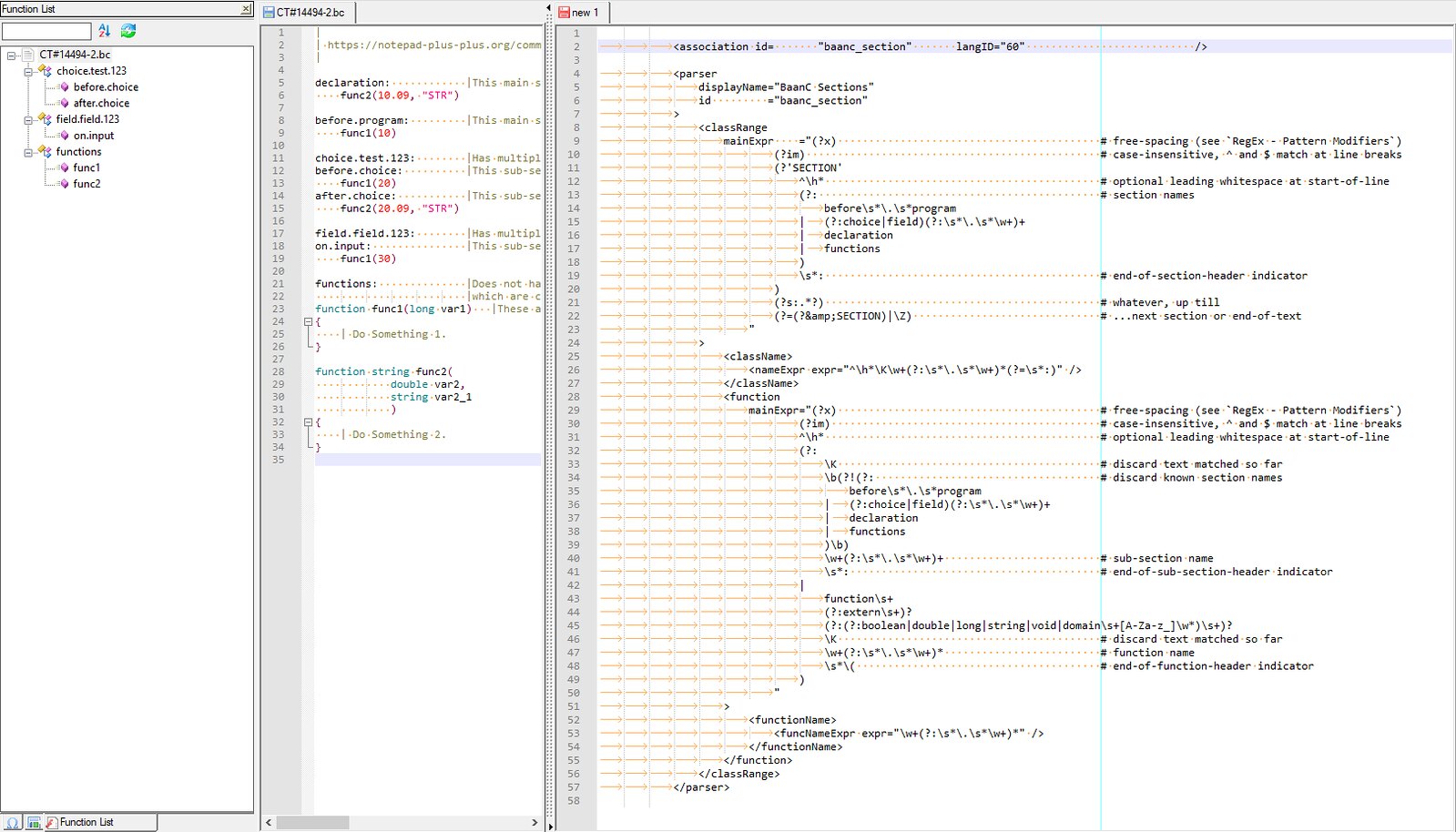

                            @oirfeodent Please try the following parser:
                            			|   Based on:
                            			|       https://notepad-plus-plus.org/community/topic/14494/functionlist-classrange-question
                            			<parser
                            				displayName="BaanC Sections v3"
                            				id         ="baanc_section"
                            				<classRange
                            					mainExpr    ="(?x)                                          # free-spacing (see `RegEx - Pattern Modifiers`)
                            							(?im)                                               # case-insensitive, ^ and $ match at line breaks
                            							(?(DEFINE)                                          # definition of sub-routines
                            								(?'SECTION'
                            									^\h*                                        # optional leading whitespace at start-of-line
                            									(?:                                         # known section names
                            										(?:after|before)\.(?:report\.\d+|\w+(?:\.\w+)*\.\d+)
                            									|	(?:field|zoom\.from)\.(?:all|other|\w+(?:\.\w+)*)
                            									|	(?:footer|group|header)\.\d+
                            									|	choice\.\w+(?:\.\w+)*
                            									|	detail\.\d+
                            									|	form\.(?:all|other|\d+)
                            									|	functions
                            									|	main\.table\.io
                            									\h*:                                        # end-of-section-header indicator
                            								(?'SECTION_EMPTY'
                            									(?:                                         # known `empty` section names
                            										after\.(?:form\.read|program|receive\.data|update\.db\.commit)
                            									|	before\.(?:(?:display|new)\.object|program)
                            									|	declaration
                            									|	on\.(?:display\.total\.line|error)
                            							(?&amp;SECTION)                                     # section header
                            							(?s:.*?)                                            # whatever,
                            							(?=                                                 # ...up till
                            								(?&amp;SECTION)                                 # ...next section header,
                            							|	(?&amp;SECTION_EMPTY)                           # ...next `empty` section header
                            							|	\Z                                              # ...or end-of-text
                            					<className>
                            						<nameExpr expr="^\h*\K\w+(?:\.\w+)*\h*:" />
                            					</className>
                            					<function
                            						mainExpr="(?x)                                          # free-spacing (see `RegEx - Pattern Modifiers`)
                            									\K                                          # discard text matched so far
                            									(?:                                         # known sub-section names
                            										after\.(?:choice|d(?:elete|isplay)|f(?:ield|orm)|group|input|layout|re(?:ad|write)|skip\.(?:delete|(?:re)?write)|write|zoom)
                            									|	before\.(?:ch(?:ecks|oice)|d(?:elete|isplay)|f(?:ield|orm)|group|input|layout|print|re(?:ad|write)|write|zoom)
                            									|	check\.input
                            									|	domain\.error
                            									|	init\.(?:f(?:ield|orm)|group)
                            									|	on\.(?:choice|e(?:ntry|xit)|input)
                            									|	read\.view
                            									|	ref\.(?:display|input)
                            									|	selection\.filter
                            									|	when\.field\.changes
                            									\h*:                                        # end-of-sub-section-header indicator
                            									function\h+
                            									(?:extern\h+)?
                            									(?:(?:boolean|double|long|string|void|domain\h+[A-Za-z_]\w*)\h+)?
                            									\w+(?:\.\w+)*                               # function name
                            									\s*\(                                       # end-of-function-header indicator
                            						<functionName>
                            							<funcNameExpr expr="\w+(?:\.\w+)*(?:\h*:)?" />
                            						</functionName>
                            					</function>
                            				</classRange>
                            				|   Note:
                            				|       Having the following `function`-node active will result in all branches
                            				|       except the last branch to show their leaves twice in the tree.
                            				<function
                            								|	before\.(?:display\.object|new\.object|program)
                            								|	declaration
                            								(?i:function)\h+
                            								(?:extern\h+)?
                            								\w+(?:\.\w+)*
                            								\s*\(
                            					<functionName>
                            						<nameExpr expr="\w+(?:\.\w+)*(?:\h*:)?" />
                            					</functionName>
                            				</function>
                            			</parser>
                            • O
                              oirfeodent
                              @MAPJe71 said:
                                                          (?i:function)\h+
                                                          (?:extern\h+)?
                                                          \w+(?:\.\w+)*
                                                          \s*\(
                              I have changed the \h+ to \s+ so that functions spanning multi-lines are shown properly. Do you see any issues with that?
                              Another point is about embedded comments… for below sample
                              function extern 	|Test
                              long test()
                              if I remove the “|Test” it is shown in the Function List panel… but, with the comment in place it doesn’t show this function.
                              So, is there a possibility to check for the presence of comments and ignore the same?
                              @MAPJe71 Thx so far for your time and effort.
                              • M
                                MAPJe71
                                @oirfeodent comments “embedded” in the function/method header are not supported (see also parse steps in earlier post).
                                • O
                                  oirfeodent
                                  @MAPJe71
                                  I thought with the <parser> “commentExpr” -attribute it is not possible to have embedded comments.
                                  I was playing around with RegexBuddy with the simplest version of the function parser and used the following regex to have the function name highlighted with embedded comments.
                                  function\s+(\|\w*)*\s+\K\w+(?:\.\w+)*\s*\(
                                  However it failed with the regular function without embedded comment.
                                  function |TEST
                                  test()
                                       |highlighted function name
                                  function test()
                                        | No highlight. (I guess regex is not correct to handle both)
                                  So, I thought there could be a better way for doing this which I am not aware.
                                  Hence the question, as the “commentExpr” attribute is not defined.
                                  If no other way, then also fine. Thx.
                                  Regards,
                                  M 1 Reply Last reply Oct 17, 2017, 6:49 AM Reply Quote 0
                                  • M
                                    MAPJe71 @oirfeodent
                                    @oirfeodent new attempt:
                                    			|   Based on:
                                    			|   Note(s):
                                    			|   1.  Boost::Regex 1.58-1.59 do not correctly handle quantifiers on subroutine calls
                                    			|       therefore the additional non-capturing group i.e. "(?:(?&amp;COMMENT))?" instead
                                    			|       of simply "(?&amp;COMMENT)?"
                                    			<parser
                                    				displayName="BaanC Sections v4.2"
                                    				id         ="baanc_section"
                                    				<classRange
                                    								(?'SECTION'
                                    									|	detail\.\d+
                                    									|	functions
                                    									|	main\.table\.io
                                    								(?'SECTION_EMPTY'
                                    									|	declaration
                                    							(?=                                                 # ...up till
                                    								\s*
                                    					<className>
                                    					</className>
                                    					<function
                                    									(?'COMMENT'
                                    										\s*\x7C[^\r\n]*                         # trailing comment
                                    										(?:                                     # optional subsequent comment
                                    											(?:\r?\n|\n?\r)                     # - mandatory line-break
                                    											\s*\x7C[^\r\n]*                     # - `trailing` comment
                                    									|	check\.input
                                    									|	domain\.error
                                    									|	read\.view
                                    									|	selection\.filter
                                    									function                                    # keyword, start-of-function-header indicator
                                    									(?:(?&amp;COMMENT))?                        # optional `embedded` comment
                                    									(?:                                         # optional storage-class specifier
                                    										\s+extern
                                    										(?:(?&amp;COMMENT))?                    # ...with optional `embedded` comment
                                    									(?:                                         # optional function type specifier
                                    										\s+(?:boolean|double|long|string|void|domain\h+[A-Za-z_]\w*)
                                    									\s+
                                    									\w+(?:\.\w+)*                               # function identifier
                                    									(?:(?&amp;COMMENT)(?:\r?\n|\n?\r))?         # optional `embedded` comment
                                    									\s*\(                                       # start-of-parameter-list indicator
                                    						<functionName>
                                    						</functionName>
                                    					</function>
                                    				</classRange>
                                    				<function
                                    								(?'COMMENT'
                                    								|	declaration
                                    									\s+extern
                                    								\s+
                                    					<functionName>
                                    					</functionName>
                                    				</function>
                                    			</parser>
