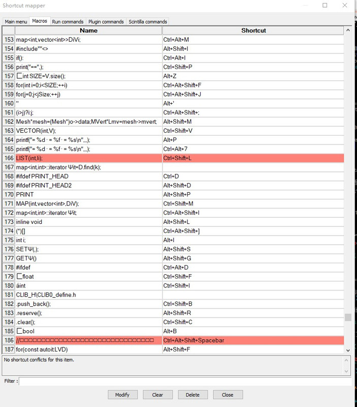

is the macros number limit to 200?
although I can set more the 200 number of macros ,but the macros that after 200 number doesn’t work.

I did a bit of searching in the code:
https://github.com/notepad-plus-plus/notepad-plus-plus/blob/89fbbad94e50e168c00ffa2ef3273f9cb4f3e3ba/PowerEditor/src/resource.h#L217It looks like
#define ID_MACRO_LIMITbeing 200 more than#define ID_MACROis the culprit. -
And it appears there is room for 1000 macros without changing anything else.
And I have 24…somehow I feel, well…inadequate now… :-)
I only have … well, it says 7, but 5 were ones that I made exclusively when debugging macro recording issues for this forum. Of the 2 real ones, only 1 do I use, and the other is an extended version of that used macro, which I never got in the habit of using.
So, if @imdjs just suggests increasing
ID_MACRO_LIMITto 20999 in the feature request, that should solve the superficial problem.Though based on the screenshot provided, it looks like most of the macros are likely typing macros (ie, code snippets). I wonder if one of the Snippet plugins (search the forum, or look in the plugin manager) might handle that feature better than Macros for the OP.
