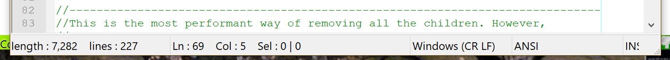

                      The plugin is this one: https://sourceforge.net/projects/notepad-linter/
                      Here is a screenshot of my normal statusbar - with no space left on it for anything at all: https://gyazo.com/cd5b12876069d6694296b5431714f98e
                      and this is what I get if I widen it up a lot: https://gyazo.com/8af0517a4f49c061f724d82815cf2b41
                      The little blue line you can see at the right of the 1st one or about 2/3 across the 2nd one is the 80 column mark.
                      Notice also the large amount of unused space on the status bar.

                        So you want to be able to read what’s in the section on the left of the status bar where you would normally see the file type (aka programming language name), even when the screen isn’t wide enough? Which in your example was “- Missing JSDoc @ returns declarion. (jsdoc/require-returns)”?
                        That’s a good question. I don’t have a full answer yet: so far, I haven’t been able to.
                        Details:
                        I know that in PythonScript, you can use the notepad.setStatusBar(STATUSBARSECTION.DOCTYPE, '...text...') to change the value of that section of the status bar. But as of PythonScript 1.3.0.0, there isn’t an equivalent notepad.getStatusBar(STATUSBARSECTION.DOCTYPE) (I know, because I was just looking for such a thing a few days ago). You can read what’s normally there (the language description) using notepad.getLanguageDesc(notepad.getCurrentLang()).
                        The other scripting plugins (see links below) probably have similar interfaces. But maybe one of them has an equivalent .getStatusBar(SECTION) notation. If so, you could use that to extract the value, and pop it to a msgbox or similar, depending on the
                        Hmm, maybe it’s available as one of the Notepad++ messages… I’ll go do some more searching, and post a follow-on, if I can find something more.
