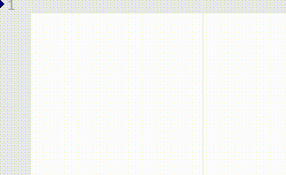

      Something like this:
      Not press some key, button, or click some option.
      Indent-by-Fold seem like the most closely plugin, but after press enter you’ll get
      | for cursor
      if{
      not
      if{
      and sometimes this plugin has it own bug
      if{
      if{
