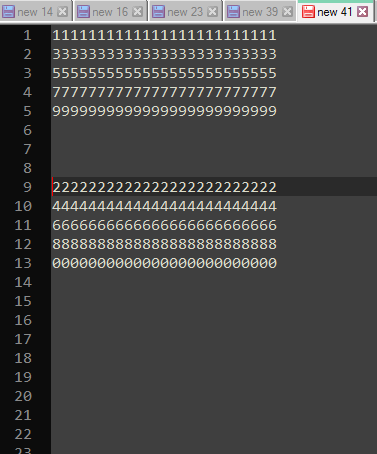

              • astrosofistaA
                astrosofista @Fernando Sorensen
                Hi @Fernando-Sorensen and All:
                Yet another way to combine two blocks of text. It’s really easy to implement and requires just the multi-edition preference enabled and the BetterMultiSelection plugin activated, which you can download and install via the Plugins Admin.
                Firstly an animation and below a step by step description:
                Giphy
                1. Place the caret at the beginning of the second text block, which will be the inserting text.
                2. Do a block selection, that is, mouse-click at the left of character 2 and then another mouse-click at the end of the same block, but this time while pressing Shift + Alt.
                3. Copy the selected block (Ctrl + C).
                4. Go to the first character of first block text (Ctrl + Home) and mouse-click at the left of the first 1.
                5. Insert a multi-selection by pressing Shift + Alt + Arrow Down 4 times, till the bottom line of the text block.
                6. Press Arrow Down one more time (without Shift or Alt) in order to move the multi-selection one line down.
                7. Press Enter to add five lines to the text block.
                8. Paste (Ctrl + V) to combine both text blocks.
                That’s all. Hope you like it.
                C 1 Reply Last reply Reply Quote 4

                                  • C
                                    Cooeeeee @astrosofista
                                    @astrosofista I use a method similar to yours that works without any plugins (unless those are default plugins that I also have). I add blank lines to both the source and destination block (search: [\r\n]+ replace: \r\n\r\n. I then Alt+Shift block select the source block, cut, position the cursor on the first blank line in the destination and paste.
                                    C astrosofistaA 2 Replies Last reply Reply Quote 2

                                          • astrosofistaA
                                            astrosofista @Cooeeeee
                                            Hi @Cooeeeee
                                            I see. The point of my post was to simplify @Fernando-Sorensen’s method, because although ingenious, it requires several steps. The basic idea was to do everything without additional windows, be it a second editor, the column editor or a search window, that would block or cut off the flow of the operation.
                                            The only thing that the BetterMultiSelection plugin is good for in my approach is precisely to insert the blank lines, an operation that standard multiselection cannot do - see @Alan-Kilborn’s post below - . But if the text already has blank lines interleaved, then the plugin is not necessary and, as your .gif shows, line interleaving can be done directly with standard multiselection.
                                            Which is the best method? For the reasons detailed above and because I have nothing against third party plugins either - in fact, I think they are a great addition to Notepad++ and heavily use them - I still prefer mine, but I have no objection to people using the one they find best.
