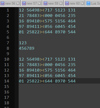

        Hello, @czmaniak, @alan-kilborn, @peterjones, @ekopalypse, @astrosofista,
        Regarding the Python problem, I deleted my Python install and re-installed the plugin with, unfortunately, the same result. My python27.dll library has version 2.7.17150.1013 and contains 2,649,600 bytes. But, never minds : it should be related to my old Win-XP laptop !!
        Now, Alan, assuming the text,below :
        123
        456789
        12 56498><717 5123 131
        21 78483><000 0456 235
        16 89410><575 5156 464
        97 89411><056 6045 454
        01 25822><644 8970 544
        123
        456789
        123
        456789
        I did your test, without any plugin, involved :
        • I placed a caret, between the > and < chars inside the first block, so 5 ones, using the Ctrl key
        • Then, hitting 9 times on the Down arrow, only, I obtained exactly what you got !
        • Now, cancel any null selection
        • Create a normal column selection, between the > and < chars of the first block
        • Then, hitting 9 times on the Down arrow, only, anunique cursor was present on the 5th line of the second block
        • Now, enable the BetterMultiSelection plugin
        • Place a caret, between the > and < chars inside the first block, so 5 ones, using the Ctrl key
        • If you hit 9 times on the Down arrow, only, this time, the 5 carets are correctly located, between the > and < chars of the second block of five lines :-))
        • Cancel any null selection
        • If you hit 9 times on the Down arrow, only, again, the 5 carets are correctly located, between the > and < chars of the second block of five lines :-))
        So, the @dail’s BetterMultiSelection plugin is definitively a must and should be installed and enabled every time ;-))
        IMPORTANT : To cancel any complicated number of selections, resulting of the use of the BetterMultiSelection plugin, simply hit the ESC key !
        Cheers,

              @guy038, @alan-kilborn, All
              I tried to replicate your tests as long as I understood them, with just Notepad++ basic multiselection feature, that is, disabling the BMS plugin and without running Ekopalypse PS:
              Giphy
              In the first test I created a null selection column by pressing Shift + Alt + Down Arrow 5 times. As soon as I moved the caret down with an arrow key, the multiselection got lost. End of test.
              Second test. Created a null selection column pressing Cntrl + Click 5 times. Moved it down and arrived to line 14 with 5 cursors but misalignated. To resolve this unwanted result hit End and all the 5 cursors aligned at the end lines —or hit Home to get a similar output—. Then went up and got the same as before.
              Conclusion: It matters how the multiselection is created. I’m really puzzled.
              Best Regards
