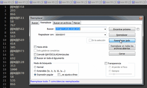

        As far as I can see, this can’t be done natively in Notepad++ —at least it would not be an easy task, maybe a really complex regex could accomplish it—, but it is doable by extending Notepad++ capabilities via scripting, specifically, by means of the Python plugin.
        Let me show you how can it be done:
        Giphy
        Quick instructions:
        1. Install the Python plugin.
        2. Copy Ekopalypse’s script from here
          https://community.notepad-plus-plus.org/post/51832
          and save it in the “Scripts” directory (access it from the mentioned plugin). Say you named it “Select all same words”.
        3. Open the Find dialog box and apply the following regex to your list of numbers:
            Search: (?-s)^.+\R.+\R.+\R
            Replace: @@#@@$0
        1. Select the sharp # and execute the Python script “Select…”. All the sharp characters will be selected.
        2. Open the Column Editor and set 1 as initial number and also 1 as the increment.
        3. Press OK and all the # will be replaced with successive integers, as you wanted.
        Hope this makes sense :)
