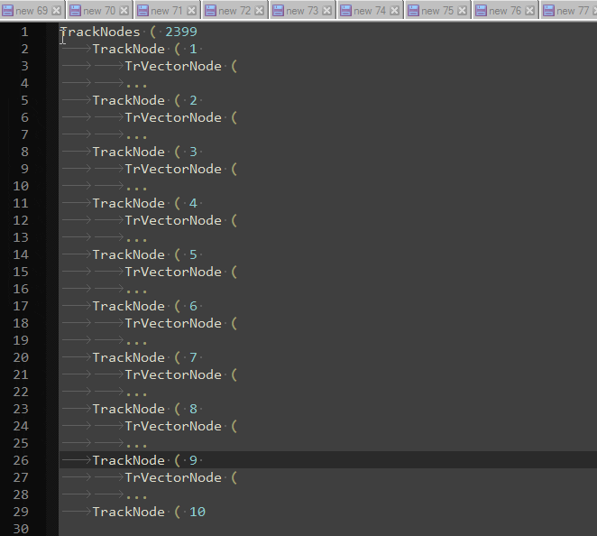

      @Paolo-Serpi said in Replace string:
      I’m looking for a method to replace automatically this tracknode string progression because it repeats 2399 times.
      Hi Paolo
      Did you mean something like this…?
      Giphy
      This method requires the instalation of the Python plugin. If that is not an inconvenient, let me know it and I will provide you next steps.
      Best Regards.

          @astrosofista Yes! This is exactly what i’m lookin’ for! So i’ve installed Phyton plugin can you explain how you can do the multiselection?!
          Thanks
          Alan KilbornA astrosofistaA 2 Replies Last reply Reply Quote 0
              Thanks
              Hi Paolo:
              Have you installed the Python script (PS) mentioned and linked by @Alan-Kilborn? If you did so, check Preferences > Editing > Multi-Editing Settings > Enable (Ctrl+Mouse click/selection) if needed. Then copy and paste the text to be changed in a new tab, so we are sure that replacements don’t apply in unwanted zones.
              1. Now, select the first TrackNode ( up to the number —1 in my gif animation—.
              2. Run PS in order to select all the instances to change.
              3. Press the Right Arrow only one time. All the carets are located at the left of the numbers to be replaced.
              4. Press Shift + End to select the numbers.
              5. Open Column Editor and enter the initial number of the series, as it is showed in my gif.
              Once you are done, press Escape get ride of all those carets.
              Paolo SerpiP 1 Reply Last reply Reply Quote 1

                    @astrosofista I installed the PS script following the discussion linked by @Alan-Kilborn, but i can’t run PS like you said at point 2.
                    Can you explain better how i can do it?
                    I try the method of @guy038 and works perfectly.
                    astrosofistaA 1 Reply Last reply Reply Quote 2
                    • astrosofistaA Offline
                      astrosofista @Paolo Serpi
                      OK, once the Python script plugin has been installed and grabbed the Python code from the linked page:
                      1. Go to Plugins > Python Script > New Script.
                      2. Give it a name, say “Select all the same words”, and press save.
                      3. A new empty editor should appear. Copy the content into it and save it.
                      Please take care to paste the code as it is, avoiding any change, as Python is strict about whitespaces.
                      1. Go back to the TackNode page.
                      2. Select the first TrackNode ( , including the blank space before the number.
                      3. Run the Python script. To do so, go to Plugins > Python Script > Scripts, and select the PS as you named —“Select all the same words” in my example—.
                      4. All the TrackNode instances should be selected.
                      5. Continue with the other steps described in the previous post.
                      Let me know what happened.
                      Paolo SerpiP 1 Reply Last reply Reply Quote 3

                          @astrosofista Well, i try a lot of times but never happen when i run PS following your suggestions. Notepad++ select only the first "tracknode ( ". I don’t know why but the only method that up to now work is the @guy038 ‘s method.
                          I hope that this method will be useful in similar situations, because i’m lookin’ for a standard method that i can always use in these cases.
                            You need to tick that Enable box.
                            This might be your problem.
                            Note: as an alternative, it could be scripted as follows:
                            editor.setMultipleSelection(True)  # in case not enabled in the Preferences
                              @Paolo-Serpi, @Alan-Kilborn
                              I see. Let’s make sure that the Python plugin is correctly installed. I suppose you installed it with the Plugins > Plugins Admin... menu.
                              Now we are going to see if it is working properly. Please click Plugins > Python Script > Show Console. On the bottom of the console there is a text box, please type in the following code
                              notepad.new()
                              and press Run. A new document should be opened. Got it?
                              If it worked, check again Preferences > Editing > Multi-Editing Settings > Enable (Ctrl+Mouse click/selection).
                              Try once more time to run the Python script, as described in previous posts.
                              Other than these ones, I am running out of ideas.
