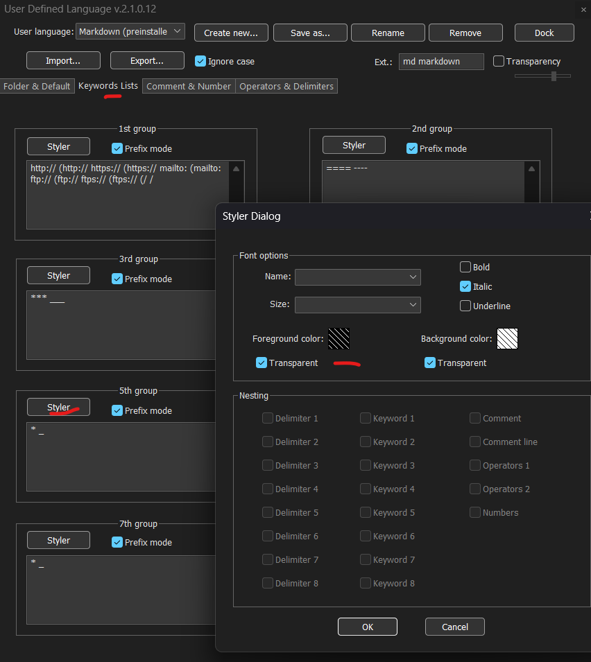

                        For future users, you need to make your own variation of the pre-installed Markdown laguage.
                        Go to Languages>User Defined Languages->Define Your Language.
                        Then click on a Styler button. I’m using dark mode and just prefer white text for formatting italics bold etc. So I set foreground to transparent, this means no colour override and uses the dark mode settings.
                        Then go to Save As and give it a name.
                        You’ll need to activate the new language variant which will be available in the Languages menu.
