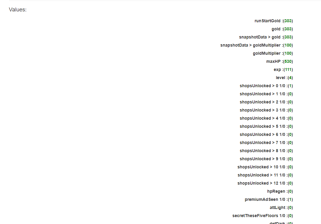

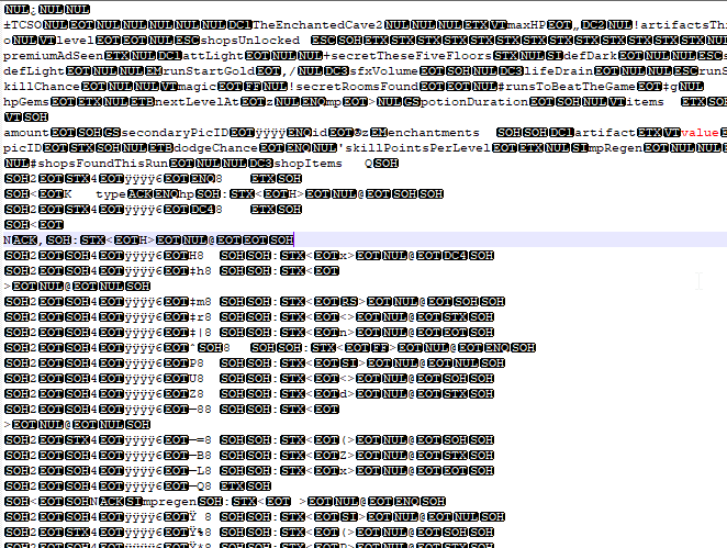

      Whenever I open a sol file it looks like this:
      However it should look like this instead;
      Any help is appreciated, thank you so much
        PeterJones @kissofkill
        @kissofkill ,
        Based on your screenshot, .sol files are binary files that happen to have text in them. Notepad++ is a text editor; if the files are not completely text, Notepad++ is not really the right application. This FAQ explains more.
        In theory, someone could write a plugin that would do the conversion to text during file load, and do the conversion ot binary during file save. However, that would require that there is someone who 1) understands the .sol format, and 2) cares enough about Notepad++ and .sol to want a plugin, and 3) has the necessary skillset. Your chances of finding someone who meets all three criteria are rather slim, even in the Notepad++ forum.
        Alternately, if there is already a .sol <=> text converter, you could set up a script using the NppExec plugin that could convert those, or using the PythonScript or similar that would hook into the file-open and file-save events to automatically run that converter. If you know of such a converter, then the pair of NppExec scripts below could be quickly modified to run that converter (right now, the gpg.exe ... lines are “placeholders” for whatever converter you use)

        Save these in the NppExec Run interface, and use NppExec to add them to the macro menu, and you could even assign keyboard shortcuts.
        (Hmm, I’ve never used it, but maybe the example Pork2Sausage plugin could be configured to run that external converter… I think that’s what it does, after all…)
        Doing it in PythonScript would be more work for me, since I don’t already have boilerplate for that, but if you absolutely had to have the conversion automatic from file open and file save commands, it could be done (and someone here might be willing to show a framework for how to do that)
        • kissofkillK Offline
          kissofkill
          Thank you so much for your detailed reply. I will try this method. I just hoped maybe someone had a plugin for it but I guess ,as you said, chances are really slim.
          • A Offline
            andrecool-68
            @kissofkill
            This is a configuration file Adobe Flash!
            What does Notepad ++ have to do with it?
              kissofkill
              @andrecool-68 I thought maybe there was a plugin for it, I thought it was a basic text file.
