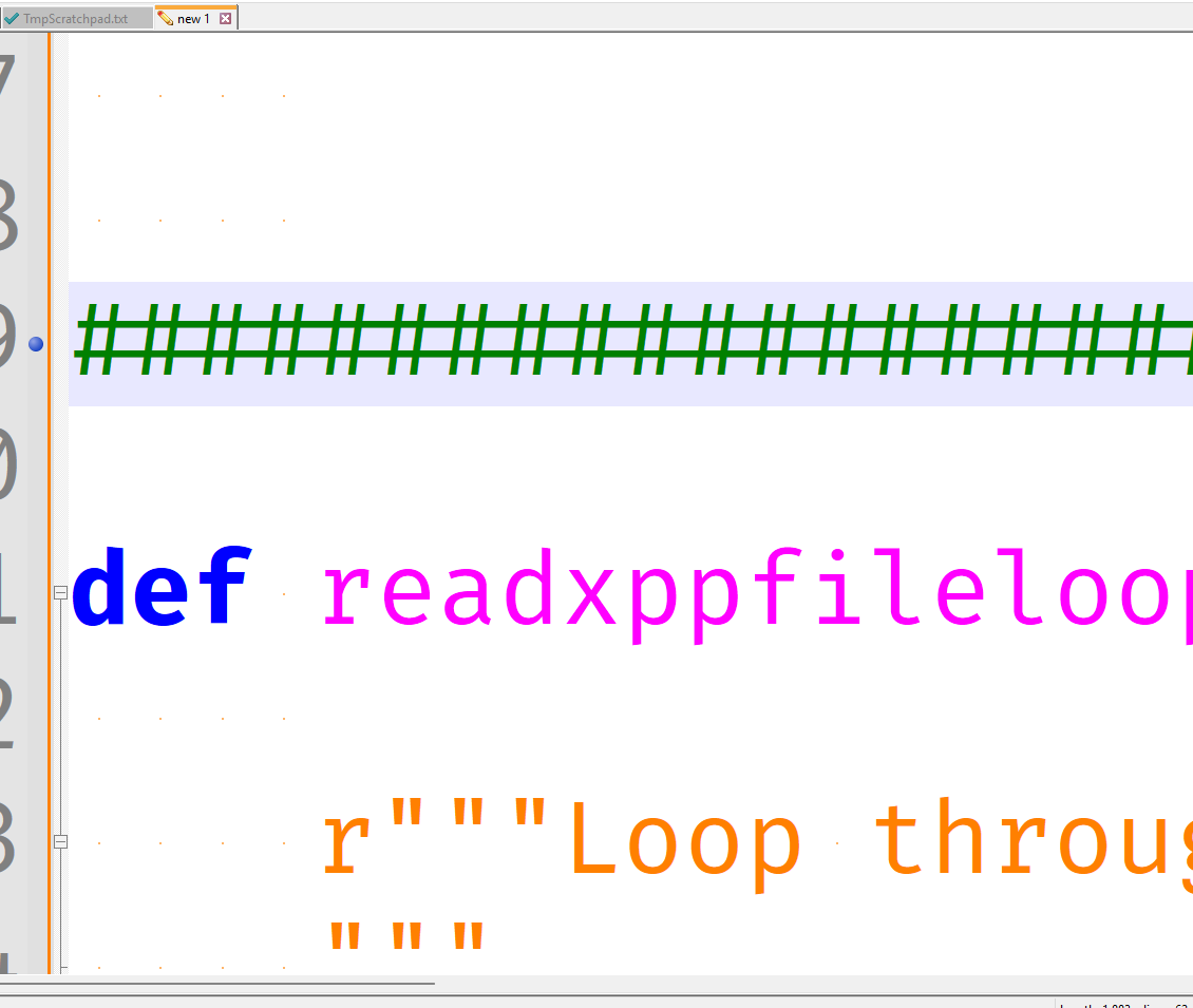

                                          PeterJones @Hashir Maher
                                          @Hashir-Maher ,
                                          I didn’t understand it two years ago when @sky-247 suggested it, and I still don’t understand it now that you reply saying it was a good idea: how does changing font size or zoom level change whether the “jump to next/prev bookmark” takes you to the middle or the top of the screen?
                                          I mean, I can understand that when zoomed fully in, that there are so few lines that the “middle” and the “top” are close to each other.
                                          But when you zoom back to normal, it’s still a few lines from the top, rather being at the top, like was requested. And I don’t see how you can make “jumping to bookmarks feel a lot smoother” using zooming in.
                                          And if you zoom out, it’s the exact opposite of what the original poster requested in 2020, in that the middle, where it jumps to, is even farther from being at the top of the screen. I mean, if it’s a short enough file, then all the bookmarks will be “near” the top, but it will be unreadable:
                                          , and when you return to normal zoom, the window might not be anywhere near the bookmark you just jumped to, so it makes the zoom-out version even more useless than the zoom-in version.
                                          Can you explain why you think that @sky-247’s suggestion is at all helpful for the original question of how to show the jumped line at the top of the screen?
