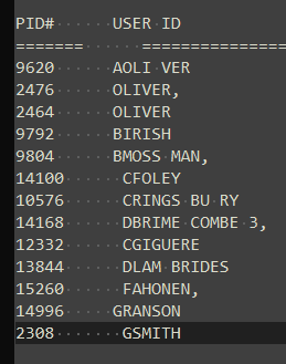

      Hi, all! Please take a look at this example.
      So, I’m using (SHIFT-CTRL-ALT + Left Click) to set this inside column (temporary column blinking cursor from top to bottom).
      How can I indent (aka backspace) all the text on each row, to the right of the blinking column, so it left aligns to this inside column I’ve selected. Is there a way to do this within NP++ itself, or do I need a plugin? I’ve been fiddling with Column Tools plugin, but no luck so far.
      I have a feeling I’m missing something obvious.
      Thanks in advance!

      • artie-finkelsteinA Offline
        artie-finkelstein
        I’d probably:
        • use \Edit\Column Editor… to insert row numbers into the document at the left most edge
        • use the NppColumnSort plugin to sort on the USER ID column
        • use regular column mode editing to remove the leading space(s) from the IDs
        • resort the file based on the index numbers added to the left most edge
        • use regular column mode editing to remove the leading index numbers
        • yell at the original programmer for not sanitizing the data before storing it <grin>

        • astrosofistaA Offline
          astrosofista @Chris Tanguay 0
          @Chris-Tanguay-0, @artie-finkelstein,
          I would do it as follows:
          Giphy
          How it works? First off, open Preferences -> Editing, and enable the Multi-Editing Settings. It also requires the BetterMultiSelection plugin activated, which you can download and install via Plugins Admin.
          Then, do as the movie shows:
          1. In the second line, place the caret at the left of the USER ID column.
          2. Press Shift + Alt and move the caret from the top line until the bottom of the list with the arrow down — you will get a giant caret blinking along 14 lines with no characters selected.
          3. Press Shift + End to select till the end of each line.
          4. Then press Shift + Control + Arrow Left to just select the spaces you want to delete.
          5. Lastly, press delete.
          You’re done. Hope you like it.

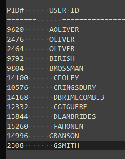

            I like the simplicity of this approach. Much nicer than my brute force scheme. Please note that success seems to be a bit dependent on the format/content of the data being lined up.
            I tried using a random sample of data, but I kept getting side effects on the last one or two entries, such as removal of the EOL on the second to last line, thus joining the last two lines. Eventually, I tracked the anomalous behavior to having a comma at the end of any row. No comma suffixes, no problems.
            FYI: The random sample was a comma separated list turned into columnar data with two of the entries given an additional indent to offset the column.
            	.REG, .VBS, .CPP, .VB, .CS, .CSS, .BAT, .CMD
            I doubt the tab before .REG makes it through the board software, but it has no effect on the outcome (although it does limit setting the initial multi-column selection).
            The reason for this long winded answer: I really, really like the approach, but the side effect with the commas is worrisome to me. You appear to have used BetterMultiSelection for much more radical cases of text editing than I have, so is this an issue with BetterMultiSelection, a limitation of ‘Multi-Editing’ or do I have an unexpected interaction with editor preferences other than the required enabling of the ‘Multi-Editing’?
            I’m using Win7 Pro x64, Npp 8.13rc 32 bit, however, neither removing all plugins other than BetterMultiSelection nor reverting to the Npp 8.11 .exe had any effect on the incorrect behavior.
            Thank you for any insight you may offer.

                I’m not sure if I understood the example, maybe a more detailed presentation, or a video, could help me to understand the problem and eventually offer you some kind of solution.
                One preference that can affect multi-editing is Preferences -> Delimiter, so check if there are any characters added to the word delimiter.
                That’s all I can think of for now.
                artie-finkelsteinA 1 Reply Last reply Reply Quote 0
                  artie-finkelstein @astrosofista
                  @astrosofista
                  Thank you. I’m using the ‘default Word character list as it is’ setting, but that was the clue.
                  I discovered that the problem only shows up if a word boundary character (i.e., non-alphanumeric and not an underscore) is present in the desired column in the Shift-End ‘expanded’ selection area. If I use a series of Ctrl-Shift-right key presses to expand the selection area to the end of column of interest AND NO FURTHER and then use a series of Ctrl-Shift-left key presses to change the selection to only the ‘undesired’ white space, it works as desired. It does not matter where the word boundary character is in the column of interest, that somehow forces a misalignment. The same misalignment occurs if there is an embedded space in the column of interest.
                  Given these ‘gottchas’, I’ll stick with my brute force approach after all, as it is content insensitive. I do note that your approach is fully applicable to the OPs question as presented.
                  Again, thank you for providing the key insight.

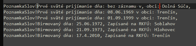

                                            Let’s see an example to illustrate these ideas, copied from this post:
                                            PoznamkaSlov!Prvé sväté prijímanie dňa: bez záznamu v, obci: Dolná Súča,
                                            PoznamkaSlov!Prvé sväté prijímanie dňa: 08.06.1969 v obci: Trenčín,
                                            PoznamkaSlov!Prvé sväté prijímanie dňa: 01.09.1999 v obci: Trenčín,
                                            PoznamkaSlov!Birmovaný dňa: 25.06.1972, Zapísané na RKFÚ: Soblahov
                                            PoznamkaSlov!Birmovaný dňa: 21.09.1973, Zapísané na RKFÚ: Hlohovec

                                            OP wanted to remove the text between the exclamation point in column 13 and the last colon, whose position varies in almost every line. There is no regular pattern of spaces, since the lines have between 5 and 7 spaces, nor is the distribution of delimiters after the colon regular. Thus, it is not possible to advance from column 13 or from the end of the line. The only interesting regularity is the exclamation point column.
                                            Another approach is needed. My first idea was to take into account a resource I mentioned in a previous message and that is to modify the word delimiter, in the preferences. If you add " ," in the corresponding field, it becomes possible to easily select the text to delete.
                                            Giphy
                                            1. Insert a multi-selection after the exclamation point column.
                                            2. Ctrl + Shift + End to select to the end of each line.
                                            3. Then Ctrl + Shift + Arrow Left to deselect up to the colon.
                                            4. Finally, delete the selected and unwanted text, pressing Back-Space.
                                            BTW, don’t forget to reset the word delimiter, or unexpected things may happen.
                                            The second idea, which came to me afterwards, turned out to be simpler - it does not require changing preferences - and is therefore better. While you can begin from the exclamation point column, for the sake of variation I’m going to start at the other end. I’m going to select column 55, that is, two characters before the colon in the last column. The idea is to remove all the unwanted characters to the right of column 55, because this creates the conditions to make a rectangular selection and easily delete the remaining text:
                                            Giphy
                                            1. Insert a multi-selection at column 55.
                                            2. Ctrl + Shift + Arrow Right to select the characters up to the colon. Repeat the action to add the colon to the selection.
                                            3. Press Back-Space to delete the selected text. We are left with a straight right margin and since the left margin is also straight, we are able to make a rectangular selection.
                                            4. Press Shift + Alt + Click after the exclamation point on the first line.
                                            5. Press Back-Space to delete the selected and unwanted text.
                                            That’s all. Hope you find this post useful.
