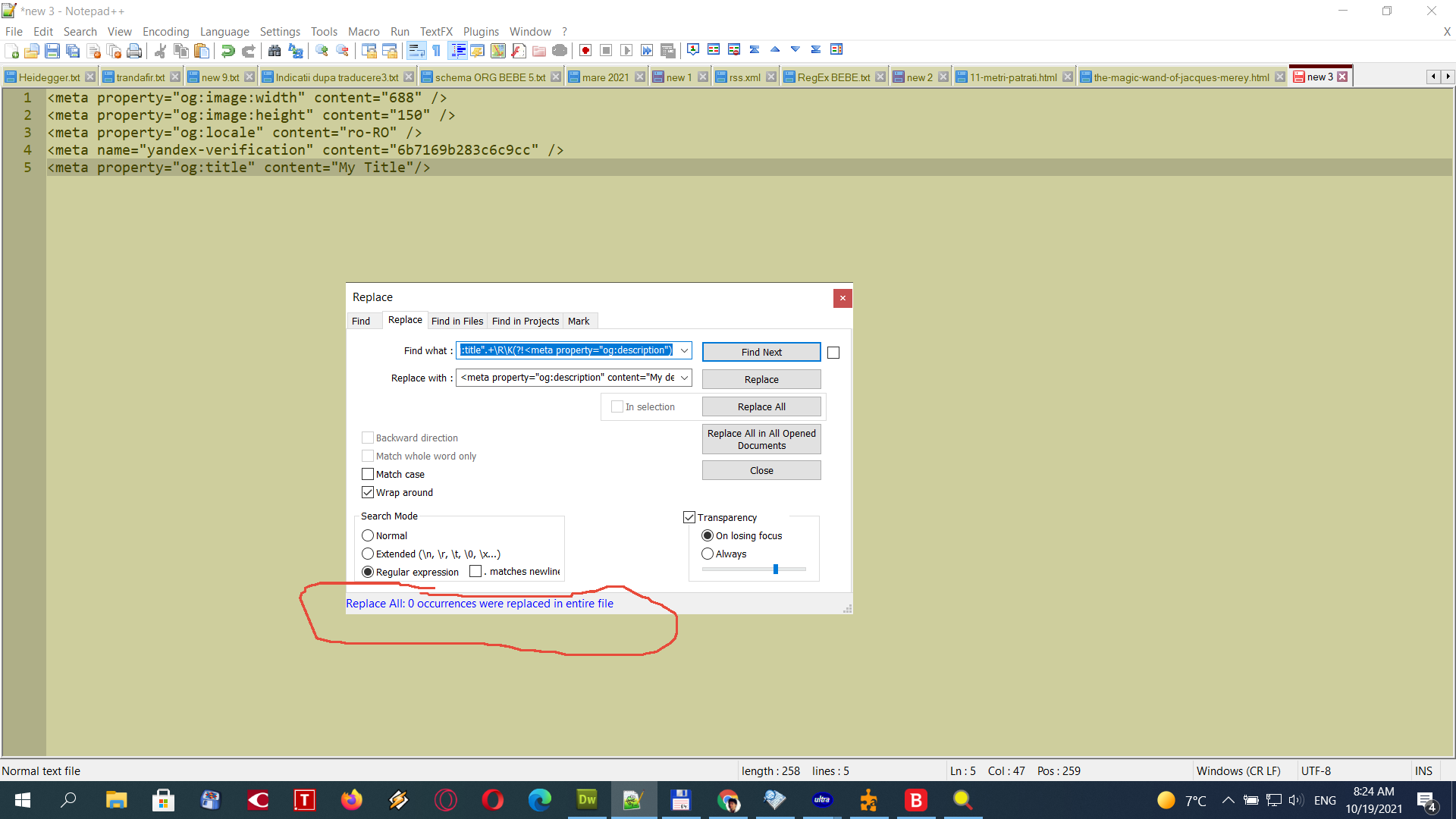

                        @guy038 said in Regex: Insert a new line in files, only if that line not exist in files:
                        (?-is)\A<meta property=“og:title”.+\R\K(?!<meta property=“og:description”)
                        something suspicios, @guy038 See this print screen please. I try your both regex formulas.
                        Terry RT 1 Reply Last reply Reply Quote 0
                        • Terry RT
                          Terry R @Hellena Crainicu
                          @Hellena-Crainicu said in Regex: Insert a new line in files, only if that line not exist in files:
                          Did you press the Replace All button as requested. As the regex uses the \K function clicking on any other option may cause the issue you see.
                          • Hellena CrainicuH
                            Hellena Crainicu
                            @Terry-R of course I press Replace All button

                              • Terry RT
                                @Hellena-Crainicu
                                Your screen print shows the Find Next button as being active, that is why I asked.
                                • guy038G
                                  Hi, @hellena-crainicu, @terry-r and All,
                                  Ah…OK. But, as your first regex attempt contains the \A assertion, relative to the very beginning of file, I wrongly supposed that the line <meta property="og:title" content="My Title"/> was always the first line of the file :-(
                                  And, from your screen-shot, the line <meta property="og:title" content="My Title"/> may also be the last line of current file, even without any line-ending char !!
                                  So here is a new version which covers all cases possible :
                                  SEARCH (?-is)^<meta property="og:title".+(?:\K(\z)|\R\K(?!<meta property="og:description"))
                                  REPLACE (?1\r\n)<meta property="og:description" content="My description of article"/>\r\n
                                  So, each time that the regex engine meets the string <meta property="og:title", with this exact case, beginning a line, it inserts, right after, the new line <meta property="og:description" content="My description of article"/>, with this exact case + its line-break chars, but ONLY IF not already followed with a line beginning with <meta property="og:description" OR IF it is located at the very end of file
