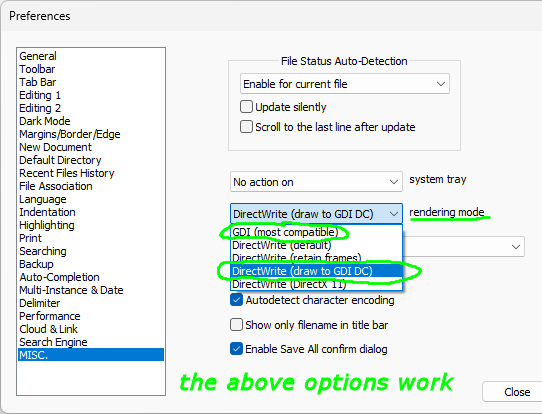

                    • Typtoe _T Offline
                      Typtoe _
                      same issue using a remote session to a windows 11 desktop with no monitor connected using chrome remote desktop
                      NPP version 8.9.4
                      fixed with:
                      Settings -> Preferences -> MISC -> Rendering Mode = change to "GDI (most compatible) -> Close
                      Restart NPP
