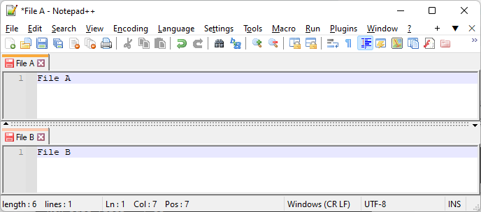

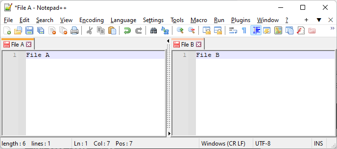

                    PeterJones @SoCu
                    @SoCu said in View of the tabs above and below:
                    one on top of the other.
                    … and although the Manual did mention it, since you seemed to not understand that section of the manual: if you haven’t changed the default Dual View setup since you installed Notepad++, they will be side-by-side rather than top-over-bottom, like
                    Side By Side Top Over Bottom
                    If you are in Side By Side, you need to right click on the bumpy line between the two and then click Rotate to right
                    This was explained in the manual:
                    To change the arrangement of the Views, right-click on the dotted bar between the two Views, and Rotate Right or Rotate Left, which will change the orientation from side-to-side to above-and-below. Given the four possible arrangements of “File A” and “File B” in separate views shown below, doing Rotate Right will go in the sequence 1→2→3→4→1→…, and Rotate Left will go in the sequence 1→4→3→2→1→… (The sequence repeats, and will start from whatever state you are currently in.)
                    SoCuS 1 Reply Last reply Reply Quote 2
