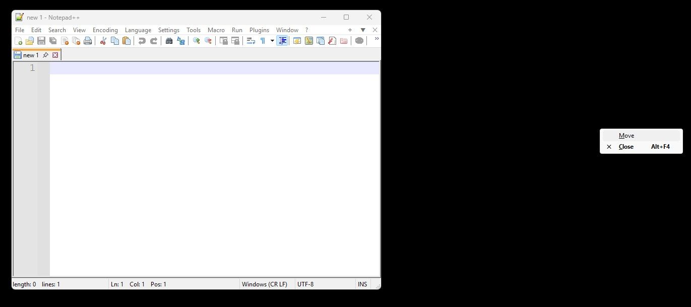

                        I have a case that I think is different from the one described above.
                        First of all, obviously, I can’t find the search results after searching.
                        Activating the search result panel with F7, then hitting Alt, then hitting ‘down arrow’, shows the menu in the screenshot below. It is tied to a fixed place on the screen. Moving the np++ window will not affect the position of the appearing menu.
                        Selecting ‘Close’ does not change anything as far as I can see.
                        Selecting ‘Move’ gives me a move mouse pointer. When click + dragging, I believe I’m dragging something invisible. After moving the invisible panel, the next time the menu appears where I dropped it. While moving I can only se my mouse pointer, nothing else. Tried with different desktop background colors without any luck.

                          xomx @henriknoren
                          @henriknoren
                          Your N++ DockingManager config is broken (IDK how this happen).
                          But you should be able to fix it yourselves by adding two additional lines to your config.xml to have:
                                  <GUIConfig name="DockingManager" leftWidth="200" rightWidth="251" topHeight="200" bottomHeight="610">
                                      <FloatingWindow cont="5" x="600" y="400" width="1000" height="600" />
                                      <PluginDlg pluginName="Notepad++::InternalFunction" id="0" curr="5" prev="1" isVisible="no" />
                                      <PluginDlg pluginName="NPPJSONViewer.dll" id="0" curr="0" prev="-1" isVisible="no" />
                                      <PluginDlg pluginName="ComparePlus.dll" id="31" curr="1" prev="-1" isVisible="no" />
                                      <ActiveTabs cont="0" activeTab="-1" />
                                      <ActiveTabs cont="1" activeTab="-1" />
                                      <ActiveTabs cont="2" activeTab="-1" />
                                      <ActiveTabs cont="3" activeTab="-1" />
                                      <ActiveTabs cont="5" activeTab="0" />
                                  </GUIConfig>
                          @peterjones
                          IMO, it’s time to unpin this issue from the top.
                          henriknorenH 1 Reply Last reply Reply Quote 0
