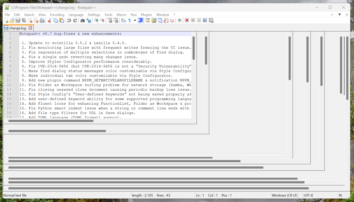

                  • mkupperM Offline
                    mkupper @Goff Fred
                    Thank you @Goff-Fred. Those screen shots were helpful. I’m fascinated and puzzled by the bottom one. I had always thought that files/tabs were always “full screen” within the Notepad application. Your Notepad++ seems to have a windowed look within the application though it’s also only showing one open tab. I’m wondering if you are using either a Notepad++ plugin or an external application to allow multiple document windows within Notepad++.
                    This is the screen shot I’m writing about:
                    Notepad++ screen shot
