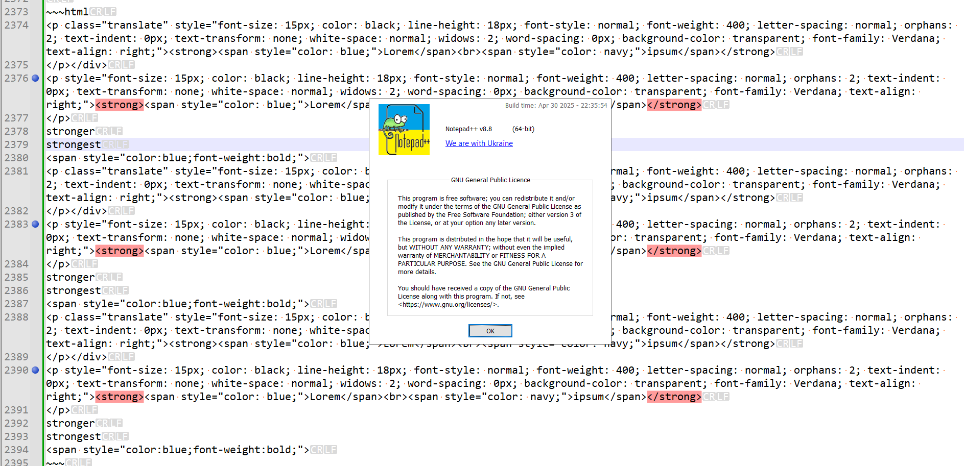

                Hello, @dr-ramaanand, @peterjones and all,
                Not very difficult to achieve ! You can use, either :
                • The regex with the (*SKIP)(*F) feature, so :
                  • FIND (?s-i)<p class\s*=\s*"translate.+?</p>(*SKIP)(*F)|</?strong>
                • The regex with the \K feature :
                  • FIND (?s-i)<p class\s*=\s*"translate.+?</p.+?\K</?strong>|</?strong>

                It would mark 6 occurrences of both <strong> or </strong> only, when found outside the ranges of text <p class="translate"...............</p> !
                So, the snapshot, below :
                Note that the second regex, with \K works nicely too because the regex engine tries :
                • The first branch of the alternative which must be matched before that the \K cancels the current match so far and just matches the part </?strong>
                • If the first branch cannot be matched, then the regex engine tries the second branch of the alternative </?strong> which returns only one of the two right expressions
