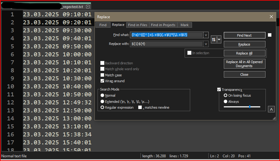

        Find What:(?-s)^(([^ ]+).+\R)(.+\R)*(\2.+\R?)
        Replace With:${1}${4}
        As this is a regular expression your search mode needs to be set to “regular expression”. Make sure the cursor is at the start of the first line as it needs to work with the first of these sorts of lines to correctly identify the “matching” pairs of dates. It will also work if there are only 2 lines with the same date, it returns the 2 lines in this instance.
        Just so you have a bit of background in how it works. ([^ ]+) works to get the date. Since your example didn’t show how a date like 3.03.2025 would actually show (could be 3.3.2025 through to 03.03.2025) I capture “non-blanks”. Now this might be an issue if you have other sort of lines (text?) in amongst the date lines, but I assumed not.
        You should run this on a copy of your file initially and spot check that it works as expected. If not, then likely you have other details you did not explain which will cause issues. Let us know how it goes and if there are changes needed, explain where it failed.

          Before:

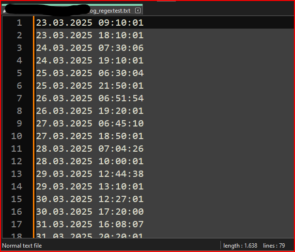

          After:
          How can you do something like that?
          Really amazing, many, many thank you!
