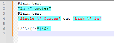

        Based on your description, I assume you are seeing something akin to
        … where the regex starts looking like a quote starts inside.
        In that example, I also showed examples of how the escape is actually intentended to work: the “Escape” character escapes the various open/close symbols _when embedded between open/close symbols. So "In \" quotes", it properly treats the \" as being inside the string, not ending the string, and similarly for the single-quote example.
        Since, based on your <Keywords...> line, you don’t have regex defined as delimiters, the parser is not in a mode where it knows it needs to escape them.

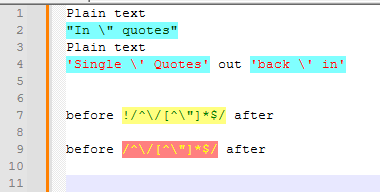

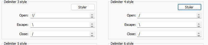

        If you define regex wrappers as delimiters as well, like:
        … then you can get it to treat the regex as a string:

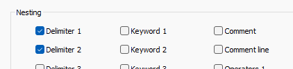

        On the other hand, if you define Delimiter 5 to be [ and \ and ] and then in the Styler definition you also allow nesting of Delimiters 1 and 2:

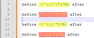

        If you escape the quotes when inside brackets, they will not be recognized as embedded quotes anymore:
