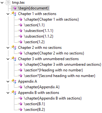

          which will yield:
          You can, of course, feel free to tweak it to match your desires.
          (Also, note that any class (ie, chapter) that doesn’t have a function (ie, section or similar) will not be listed in the FunctionList. That’s one of the quirks of the FunctionList.)

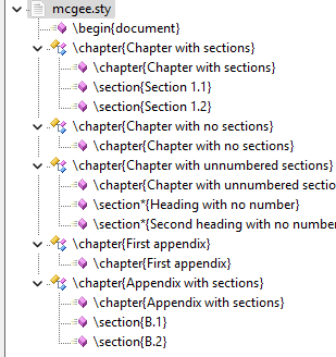

              With the way that the nesting works for FunctionLists (they don’t just do one regex; they do regex just on the results of previous regex, and it gets confusing), I am not certain how to accomplish that.
              I thought I could try to relax some of the rules, so that inside a \chapter, anything starting with \ would start a function (even the chapter!) – and because the chapter would match, then it would have contents. And that “worked” (as long as you don’t mind having each \chapter class repeated as a function in that class, too):
              But, unfortunately, as you can see, it doesn’t pick up the \appendix or the \include. If you needed it to, then this wouldn’t work for you. But if that’s an okay compromise, then here’s an XML

                And the result on the sample file:
                I modified the classRange mainExpr because I wanted to also match indented \chapter{}s (like I have for the appendices in the new sample file). After that change I found that the last \chapter{} wasn’t being matched with \Z so I changed the alternate search to look for \end{document} instead (which will always appear) and that worked.
                Thanks for your help!
