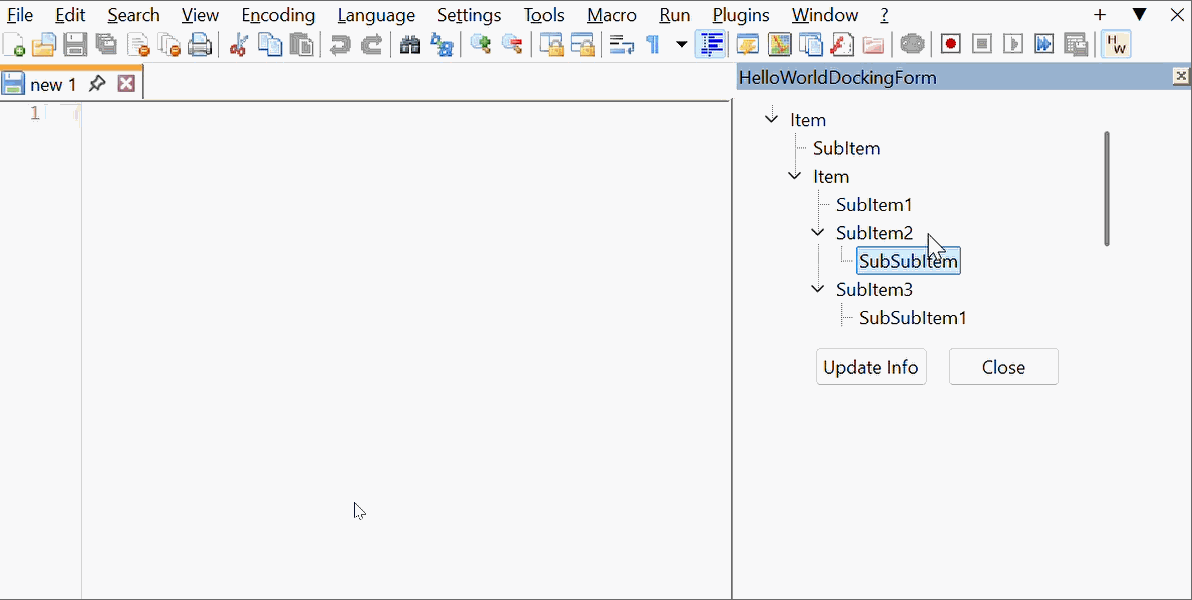

      Just trying to activate rename capabilities in my plugin (written in Lazarus/FreePascal) using inplace editors for treeview and listview, i did run again into a strange phaenomen that i’d never encountered in regular stand-alone apps before.
      That is, once the item editor is opened, it will close only within too few cases. It’s only closed by: click on anther node; or: via Cancel key; or via value change and press <Enter>.
      It does NOT close if i click onto another control, for instance, or when clicking into another window, eg. the NPP editor area. It appears the message flow is somehow disturbed.
      I’d have three questions:
      1. Can someone imagine what might be the possible reason?
      2. Is such behaviour already known for other plugins?
      3. Could maybe someone replicate if this does occur also with Delphi?
      Steps:
      Take some demo app having a treeview, and set the treeview to not be readonly.
      Open an inplace editor on a tree node by any means, eg. a lazy doubleclick.
      Click onto any other control with the docking form, or onto NPP’s editing area.
      What does happen?
      CoisesC rdipardoR 2 Replies Last reply Reply Quote 0

              • I built the plugin and placed it in the load path of a compatible N++ version.
              • I clicked the toolbar button to show the docking form.
              • I double-clicked a list item and typed into it.
              • With focus still on the item, I moved the mouse pointer into the buffer window, then clicked.
              • Focus moved into the buffer window:
              I did however notice a different issue, namely, when editing a TreeView item while the form is “floating” (i.e., dragged into the buffer window area).
              In that scenario, the list item’s edit control cannot be unfocused at all; it hangs up the message loop until the “Not responding” system dialog appears and you request a hard shutdown.
              The solution probably involves some variation of Damjan Cvetko’s famous hack of toggling the WS_EX_CONTROLPARENT attribute flag in the form’s WM_NOTIFY procedure. It’s just a matter of finding out whether WS_EX_CONTROLPARENT needs to be set or cleared, and in response to which DMN_* message.

                      It’s a bit hard to identify in the gif screen cast when/where a click happens. So only for confirmation: (regarding a docking, not floating window here):
                      when you write/type into the npp editor buffer, the treeview’s node editor stays open, but when you click into it, it correctly closes?
                      The latter would tell me that i encountered a Lazarus flaw here, and i’d indeed need a LCL fix or such workaround as described.
