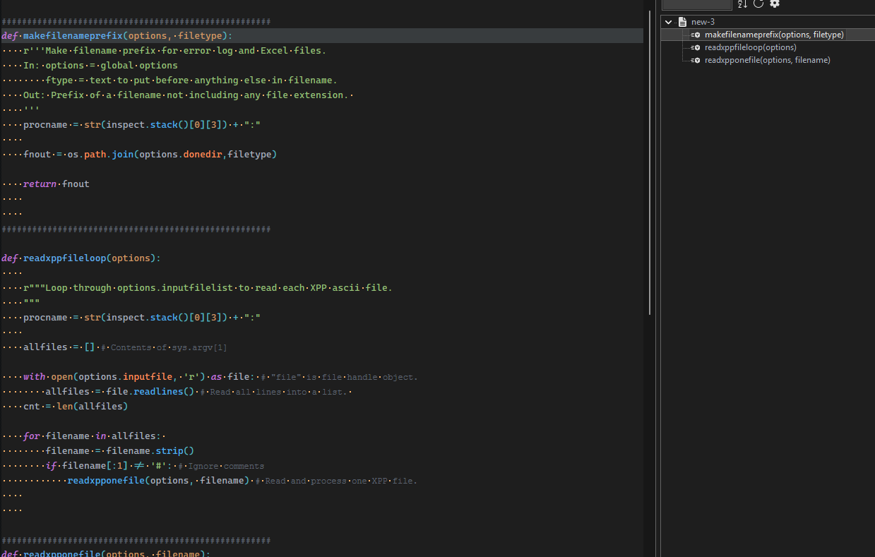

      I use Notepad++ on Windows 10.

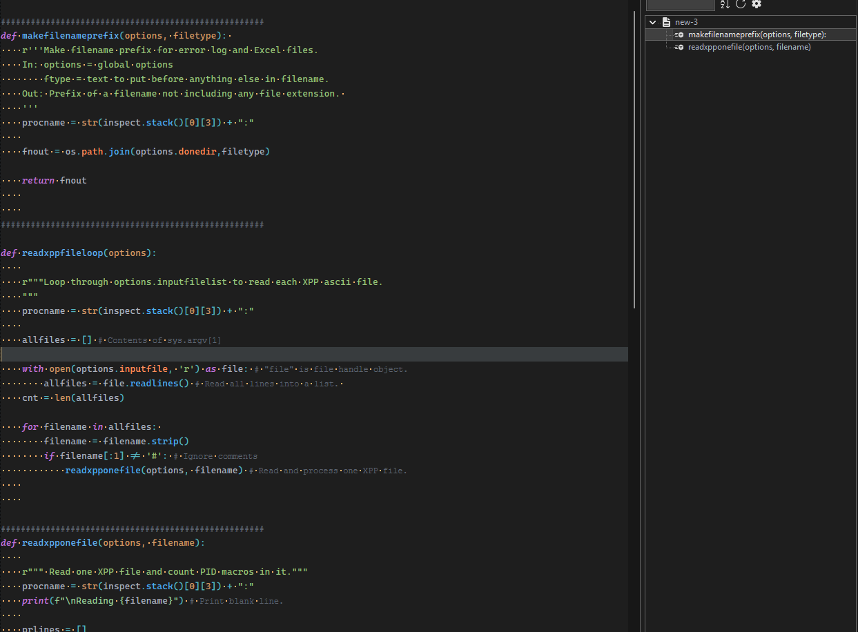

      In my main program “cntpidtype.py” I have one function “readxppfileloop” that does not show up in the function list in a sidebar on the right side of Notepad++. Above that function is a function “make filenameprefix” which shows up in the function list. Below it is a function “readxpponefile” and that shows up.
      1. When I turn on to see all hidden characters I just see normal CRLF and nothing unusual before the problem function “readxppfileloop”.
      2. I had this problem with an older version of NPP and updating it to a Feb 2025 version fixed it.
      3. If I copy and paste into another file called “test.py” the problem function “readxppfileloop” does not appear either. This tells me something may be funky with “makefilenameprefix” but I don’t know what it is. Here’s my test.py file. This is missing imports so it will not run. The program actually runs fine.
      4. I have also tried closing the file (and leaving NPP open) and reopening the file and the one function still does not appear in the function list.
      5. I don’t have any problems with any other functions in any other .py files. So there is something funky about this file perhaps.
      6. I have just used the NPP search to look for high ascii characters using regex and [\x80-\xff] and found none.
      You can try and copy and paste this code into your own NPP and see if “readxppfileloop” appears in the function list.

        Ekopalypse @C Bacca
        @C-Bacca
        I do not have an solution but can confirm the behavior.
        Now deleting the space at the end of makefilenameprefix solves it for me.

          • C BaccaC Offline
            C Bacca @Ekopalypse
            @Ekopalypse I can confirm, removing that last space fixes it. I didn’t even see that space or thought it would matter.
            There’s some regex in a settings file somewhere for NPP that searches for function names. Can this be fixed to allow trailing spaces in the next NPP update?

                  PeterJones @Ekopalypse
                  @Ekopalypse said in Some functions not shown in function list:
                  I think the regex gurus need to take a look at this.
                  Actually, the python FunctionList definition regex is pretty simple:
                  • normal function: ^(async )?def\x20\K.+?(?=(:$|,$|:\s*#))
                  • function in class: \s(async )?def\x20\K.+?(?=(:$|,$|:\s*#))
                  The problem with both is that it requires the : or , to be the last character on the line (unless there’s a comment). If both are edited so the final lookahead is (?=(:\h*$|,\h*$|:\s*#)) (edit, save, exit NPP, restart NPP), then the original file, with the extra space, will work again.
                  Analysis: It turns out, because functionlist defaults to doing a .-matches-newline search, it is actually matching from def makefilenameprefix all the way to the ending : on the def readxppfileloop(options): line: this is why the makefilenameprefix made it into the function list, but readxppfileloop did not. (I think it actually means that there’s a multi-line string being sent to the FunctionList panel… but because it only displays one line per function, you don’t notice.)
                  If there had been an if xyz: line (or any other control structure that ended with :-then-EOL) somewhere inside makefilenameprefix(), then readxppfileloop would show up, too. So there was not only “bad luck” in having the space at the end of the line, and “bad luck” that whoever developed the original functionList regex for Python didn’t think to allow whitespace, but also “bad luck” that there wasn’t another control structure inside the function. Don’t go to your local casino until you’ve broken your “bad luck” streak. ;-)
