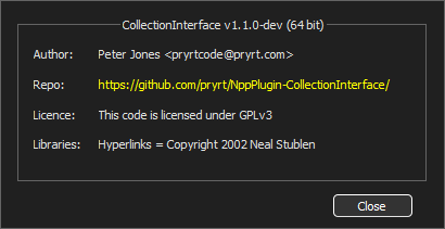

      By following the NPPM_DARKMODESUBCLASSANDTHEME and the example of adding DarkMode to MIME Tools, I was able to get CollectionInterface’s About box to be nicely DarkMode in the darkMode branch:

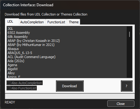

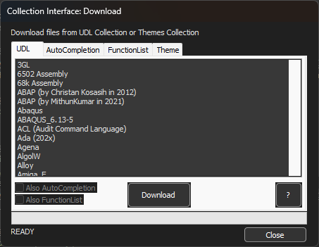

      Unfrotunately, when I followed the same procedure on the “Download” dialog for the same plugin, I came across a snag:
      … It uses a CONTROL ... "SysTabControl32" tab interface, which appears to not inherit the DarkMode when I use that message. Also, the CONTROL ... "msctls_progress32" progress bar, based on its background, appears to also not get the “magic” that the NPPM_DARKMODESUBCLASSANDTHEME is supposed to impart.
      For those who have more experience with such things than I do: Is that something I have to fix on my end – and if so, are there any instructions available, and/or examples of how? Or do I need to put in a feature request to improve NPPM_DARKMODESUBCLASSANDTHEME’s behavior?
      Secondarily: if I put the NPPM_DARKMODESUBCLASSANDTHEME “after controls initializations in WM_INITDIALOG” as recommended in the Manual (which was derived from Don’s instructions when the new message was added), then I can see the dialog initially draw itself in light-mode, then re-color at the end. If I move the message to the beginning of WM_INITDIALOG, then the dialog seems to be drawn dark initially (or changes color too fast for me to notice), which is what I’d prefer… but the scroll-bar disappears from the ListBox, and I can only scroll using arrow keys, not the bar:
      Is there a way to get it to draw the dialog dark to begin with, without breaking the functionality of standard controls like the list-box’s scrollbar?

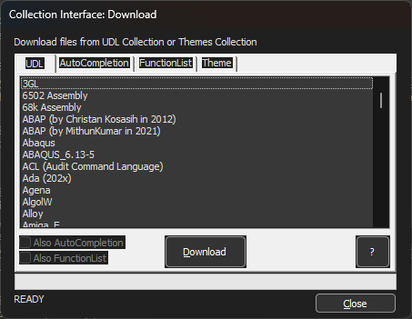

                But once you said that, I was able to look around and find where the app handles the actual tab-control, and I see it calls the method NppDarkMode::subclassTabControl() to subclasses the Tab interface for changing the color in Dark Mode… so it looks like I’ll have to duplicate that subclassing (because the message doesn’t call that separate subclassing)
                  Success.
                  So that other plugin authors can learn from my last couple of days, here is an example of what I did in order to get DarkMode to apply to the SysTabControl32 (I don’t know if it’s the best way; but it’s the way I was able to figure out):
                  In my header files, I have added a copy of some of the structures from N++ repo, including NppDarkMode.h’s struct Colors and struct Brushes and struct Pens from NppDarkMode.cpp, and then make instances of those objects as file-level globals (that’s what allows me to grab the colors using the NPPM_GETDARKMODECOLORS message, and then make sure I have the brushes/pens derived from those colors.)
                  NppDarkMode::Colors myColors = { 0 };
                  NppDarkMode::Brushes myBrushes(myColors);
                  NppDarkMode::Pens myPens(myColors);
                  In WM_INITDIALOG, I add
                  			// determine dark mode
                  			g_IsDarkMode = (bool)::SendMessage(nppData._nppHandle, NPPM_ISDARKMODEENABLED, 0, 0);
                  			if (g_IsDarkMode) {
                  				::SendMessage(nppData._nppHandle, NPPM_GETDARKMODECOLORS, sizeof(NppDarkMode::Colors), reinterpret_cast<LPARAM>(&myColors));
                  				myBrushes.change(myColors);
                  				myPens.change(myColors);
                  				// subclass the tab control, because NPPM_DARKMODESUBCLASSANDTHEME doesn't apply to SysTabControl32
                  				::SetWindowSubclass(GetDlgItem(g_hwndCIDlg, IDC_CI_TABCTRL), cbTabSubclass, g_ci_dark_subclass, 0);
                  				// For the rest, follow Notpead++ DarkMode settings
                  				::SendMessage(nppData._nppHandle, NPPM_DARKMODESUBCLASSANDTHEME, static_cast<WPARAM>(NppDarkMode::dmfInit), reinterpret_cast<LPARAM>(g_hwndCIDlg));
                  Finally, I took a copy of the TabSubclass() callback in NppDarkMode.cpp, and adjusted it so it used my color/brush/pen instances rather than the methods, and other similar tweaks to get it to compile. (And it doesn’t apparently need the WM_PARENTNOTIFY, at least not with my four-tab interface)
                  With that, I can get the tabbed-interface part of the dialog to also follow DarkMode (including the various standard or customized tones.
