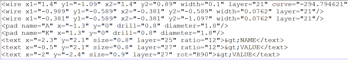

              • O
                ottiditto
                oops, the community website alters the pasted xml-file,
                her is a screenshot of the original example:

                  Sorry for the confusion:
                  <wire x1="1.4" y1="-1.09" x2="1.4" y2="0.89" width="0.1" layer="21" curve="-294.794621" cap="flat"/>
                  <wire x1="-0.989" y1="-0.589" x2="-0.381" y2="-0.589" width="0.0762" layer="21"/>
                  <wire x1="-0.381" y1="-0.589" x2="-0.381" y2="-1.097" width="0.0762" layer="21"/>
                  <pad name="A" x="-1.3" y="0" drill="0.8" diameter="1.8"/>
                  <pad name="K" x="1.3" y="0" drill="0.8" diameter="1.8"/>
                  <text x="-2.3" y="2.1" size="0.8" layer="25" ratio="12">&gt;NAME</text>
                  <text x="-0.5" y="2.1" size="0.8" layer="27" ratio="12">&gt;VALUE</text>
                  <text x="-2" y="-2.4" size="0.9" layer="25" rot="R90">&gt;VALUE</text>
                    PeterJones @ottiditto
                    @ottiditto ,
                    Then I believe changing the FIND WHAT to (?-s)^((.*? layer=")(25)(".*?>\&gt;NAME.*\R)) should do what you want – it now looks for the closing > followed by the &gt; then NAME, and will duplicate a line that matches and change the 25 in the second to a 21, with the following output:
