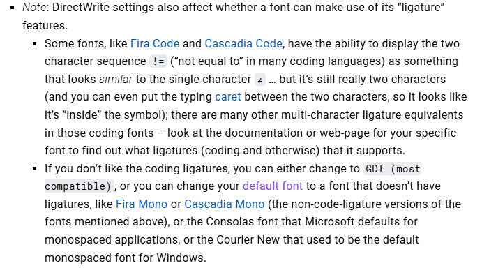

            To future readers: I have updated the User Manual’s description of the DirectWrite settings to show:
            This should hopefully help guide people in how to use or disable this feature of their chosen fonts
